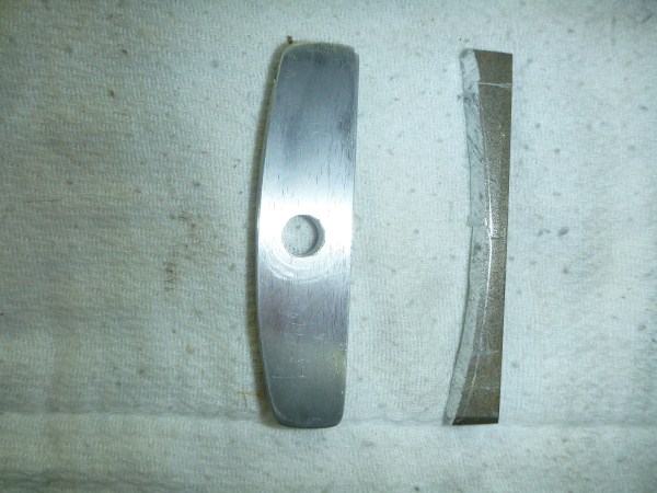

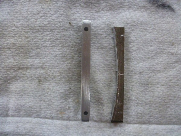

Aluminum stock, bike brake cable, and a few little things.

Hi,

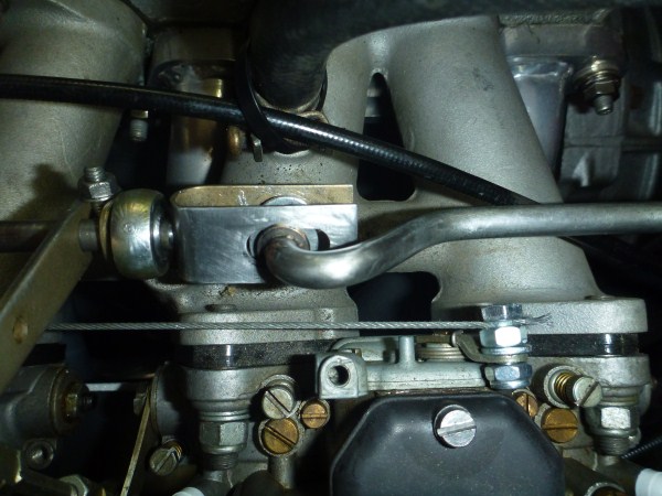

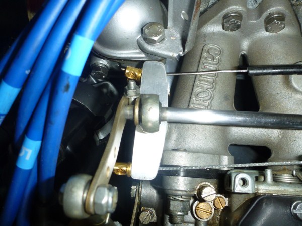

I just finished hooking up the choke to Triple Weber DCOE 40's and thought I'd share it with you:
Frist, please note I used the idea/picture from cygnusx1 as posted earlier - give credit where it's do!!
I bought a $0.30 piece of aluminum: 3'' x 1" x 1/4" which I cut to shape and then dry sanded to 1500.
I drilled out the pivot hole vertically to 5/16" and the two cable holes to 1/8" horizontally.

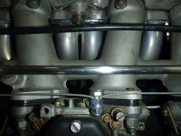

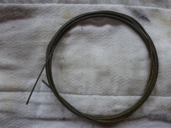

I used a 20.5" length of steel braided aviation cable to hook up the choke levers.

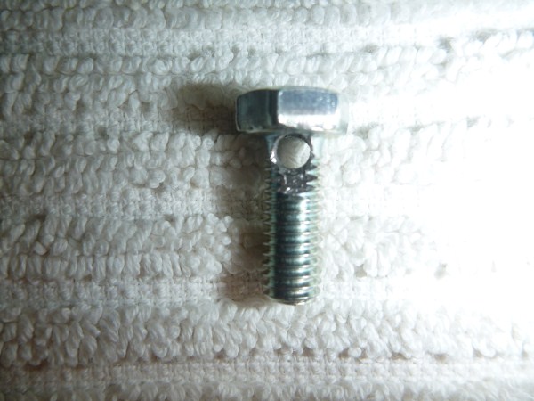

To attach the choke levers I used 6mm bolts drilled out 1/8" to accept the braided cable.

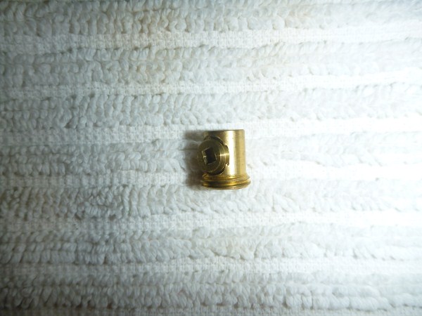

I secured both cables (the longer of the two original choke cables and the braided cable) to the bell crank lever with brass electrical connectors.
The shorter original choke cable was ligated under the 2nd and 3rd Weber - both out of the way and out of sight.
As is, the choke works with about the same degree of pull on the choke lever as withpost-28265-14150822918894_thumb.jpg the twin SU's
Regards,
George

The pictures compliment your written description very well. I really like the approach you have engineered - fewer moving parts - well done!!
George
