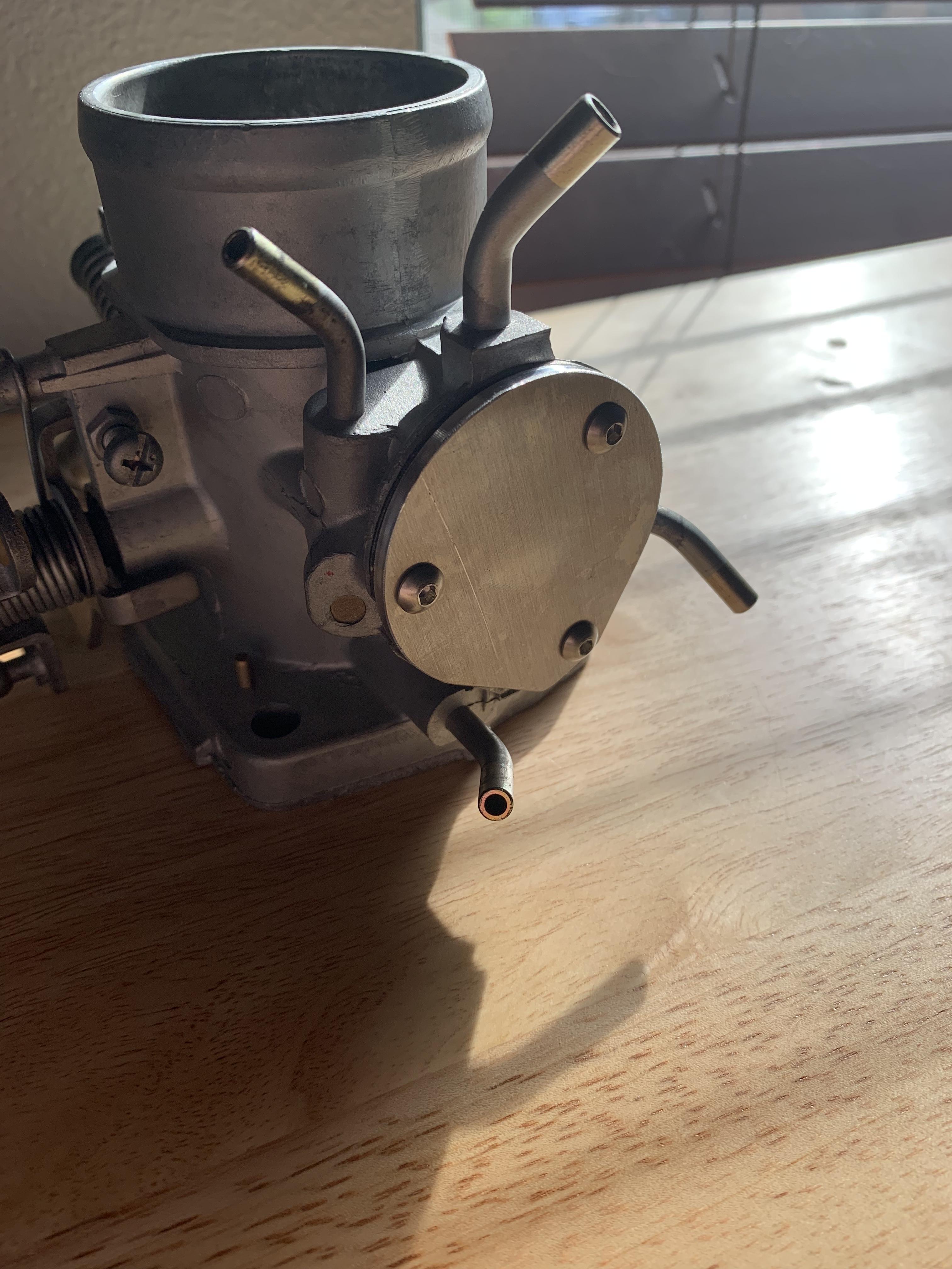

They can be made fairly easily, but if you don’t care to toil with cutting and drilling a plate or using RTV I’ve got 10 plug kits available. Works very well on my 76 280z for the last 2 years, as well as the 1980 280zx throttle body pictured below. If there’s any doubt send me a picture of the throttle body and I’ll be able to tell.

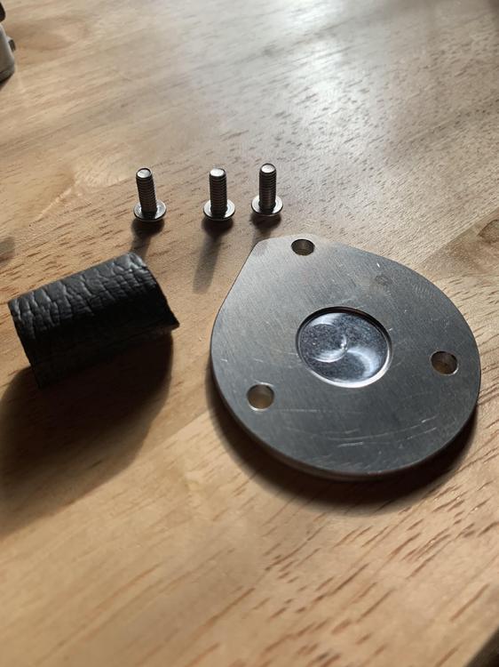

The kit has: a CNC Machined Blocker Plate, 1” Neoprene Crush Plug, and 3mm Button Head Screws (3), seal material (not pictured). Initially I re used the seal at the throttle body and it worked well but fashioned a new one later on because I wasn’t comfortable with how brittle it was. When I get my CNC router/laser back up and running I’ll cut some finished gaskets for the next batches.
