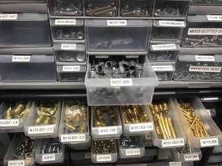

Email Dave Patten at Futofab, he has taken the reins left by Todd at Wolf Creek Racing and should be able to get you jets. Dave@FutoFab.com  The wolfcreekracing.com website leads you to Dave's contact information.
