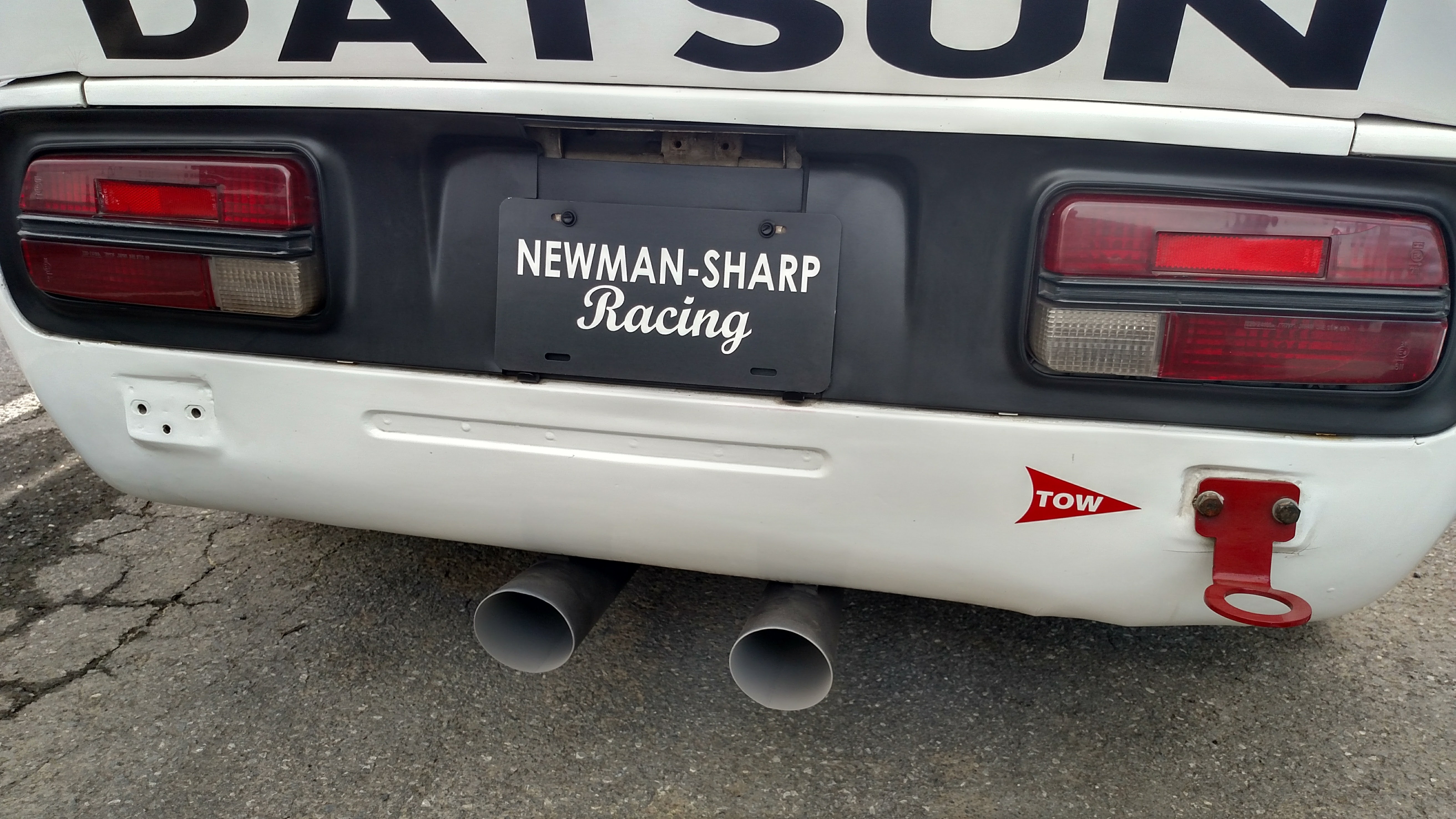

February 23, 20187 yr comment_543069 It idles quite nicely, big cam, twin trumpets, a rich rumble. There are two issues. It doesn't generate enough vacuum, so the first fix was an electric vac pump for a year and then last winter Wilwood pedals with MCs which cured that issue and two, idling or just driving back in to the garage from the track will leave a nice deposit on the plugs and top of the pistons. After a run at WOT here's the color of the exhaust... Link to comment https://www.classiczcars.com/forums/topic/42960-triple-mikuni-thread/?&page=19#findComment-543069 Share on other sites More sharing options...
April 20, 20186 yr comment_547749 On ‎2‎/‎22‎/‎2018 at 8:36 PM, gnosez said: It idles quite nicely, big cam, twin trumpets, a rich rumble. There are two issues. It doesn't generate enough vacuum, so the first fix was an electric vac pump for a year and then last winter Wilwood pedals with MCs which cured that issue and two, idling or just driving back in to the garage from the track will leave a nice deposit on the plugs and top of the pistons. After a run at WOT here's the color of the exhaust... That's about how mine looks after a highway drive on my Z with Mikuni's. On my Z with SU's, I can't get that color on the exhaust. Link to comment https://www.classiczcars.com/forums/topic/42960-triple-mikuni-thread/?&page=19#findComment-547749 Share on other sites More sharing options...
