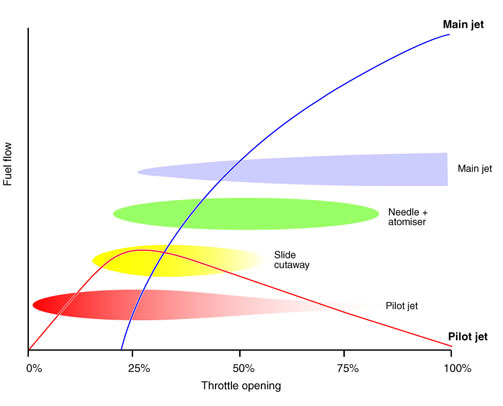

Had a break thru with the Mikuni's today. I have been tuning on these for a long time and have done well in all areas except the transition zone. It's the zone where the carbs are leaving their pilot jets and moving on to the main jets.
This zone showed up as a very lean spot to the point of stumbling and my O2 gauge showed +18 on the scale.
What I did was actually close some of the holes that were on the bleed pipe inside the emulsion tube-thus making a stronger "suck" on the main jet from the venturi WITHOUT richening WOT. It was kind of a last ditch experiment that I wanted to try before saying "good enough".
Just exciting to find another angle to tuning the triples and getting closer to FI drivability.

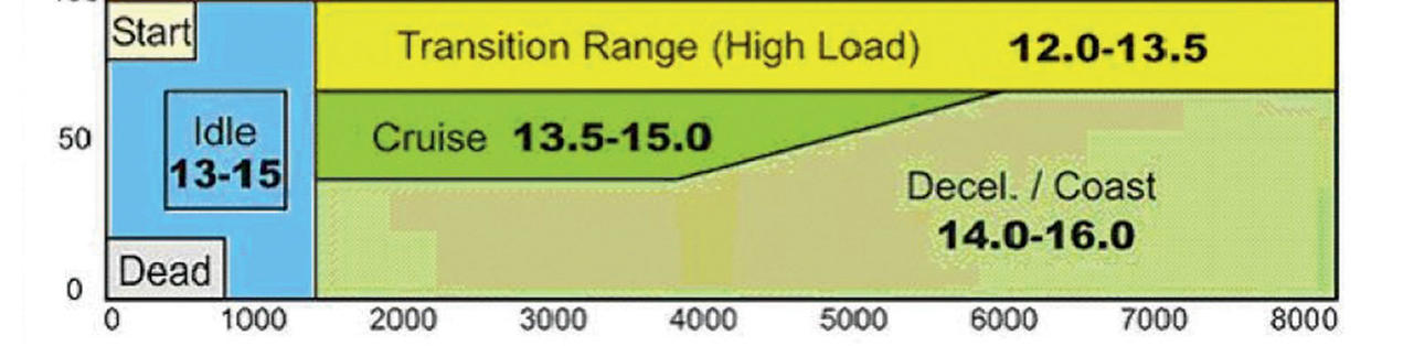

Don't bother wanting triple carbs unless you are willing to spend money on an O2 sensor(wideband) to do some real tuning. I know for a fact that my carbs run a lean 15-16AFR at cruise in 5th gear. 4th gear is more 14ish ready to pounce into the 13 teens in WOT application. Idle is almost where I want to make it. The car starts easiest with a rich idle-12-13, but the car will idle at 750rpm in the 17-18 range. The o2 sensor will also troubleshoot for the difference between ignition problems and maybe a loose jet;)

This puts the AFRs lower then I like at cruise 13-13.5 - 14 depending on gear and rpm . Taller gearing would help for cruise but then I couldn't break the rear tires loose in second gear by slamming the throttle:)

AFR@1000rpm - 13.5
AFR @ WOT - 13.5
AFR @ 60MPH - even pull - 13

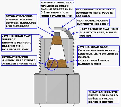

Spark Plug - BPR5ES-11
Good pulling power on low accel and high accel
Slight backfire on decel - 15 to 16 AFR
I've got some 195 airs coming from Italy (just grabbed a set of 185's from Todd also). Trying to reduce the slight backfire on decel first - then raise my AFR a little leaner next. My plugs look dry and gray.......I would like them on the more tan side though.
I bought a set of .45 pump nozzle but my car did not like that at all.
What plugs are you running - I have tried 3 different series so far. Keeping notes on the plug reading along with my jet setting so I can review my best 3 setting - then go to a dyno with my best 3 and lock and load for best performance.
