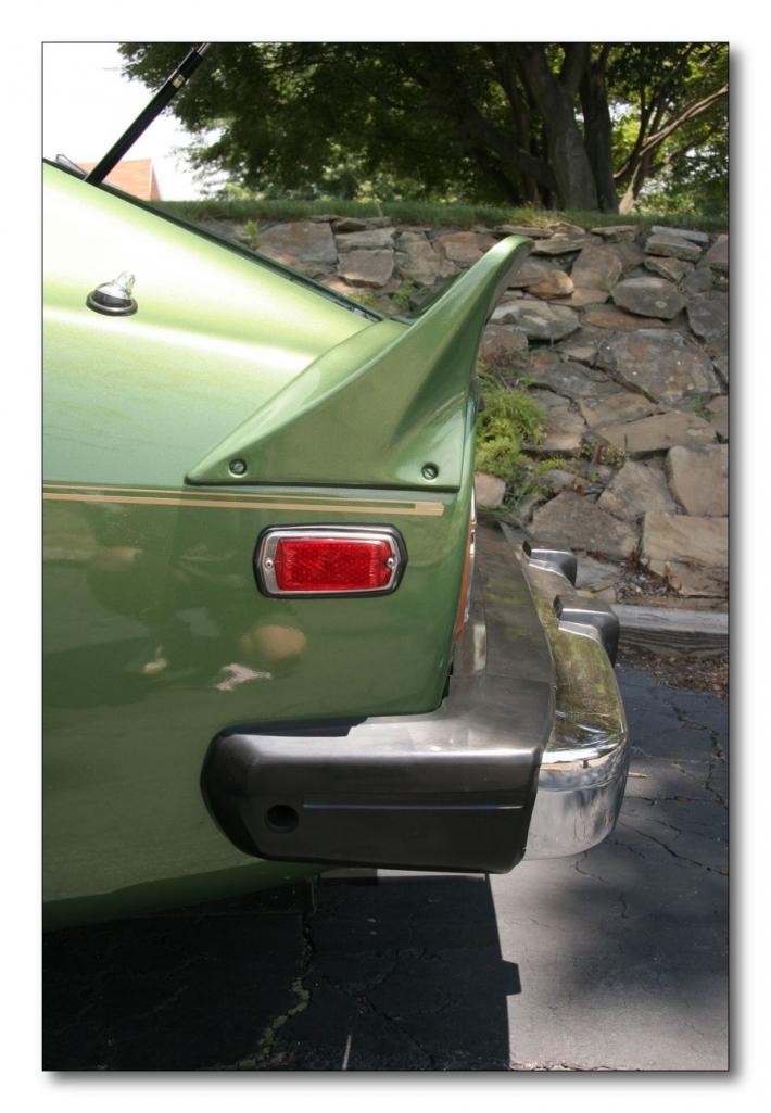

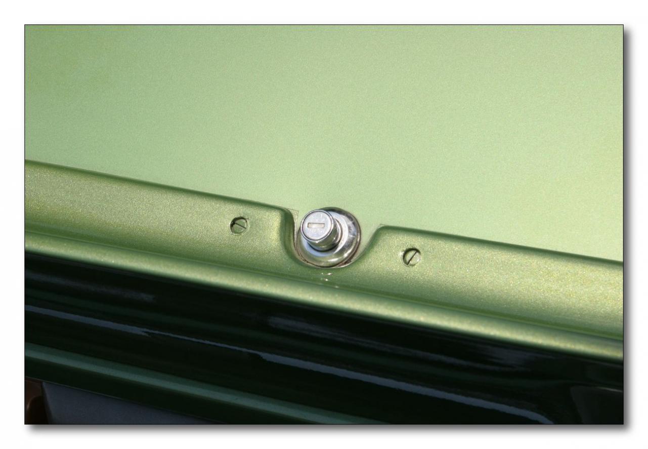

Black Gold Man here are a couple pictures of my same spoiler.
On the side pcs. there is at least one threaded stud that mounts inside on the top, this is very hard to get to and hard to get the nut on to.
I used SS metal screws as you can see on the side and the top in the middle.
I also painted the holes the SS screws screwed into and I also put a line calking all along the edges of the pieces to seal them. My spoiler has been on since 1979. Hope this helps.
