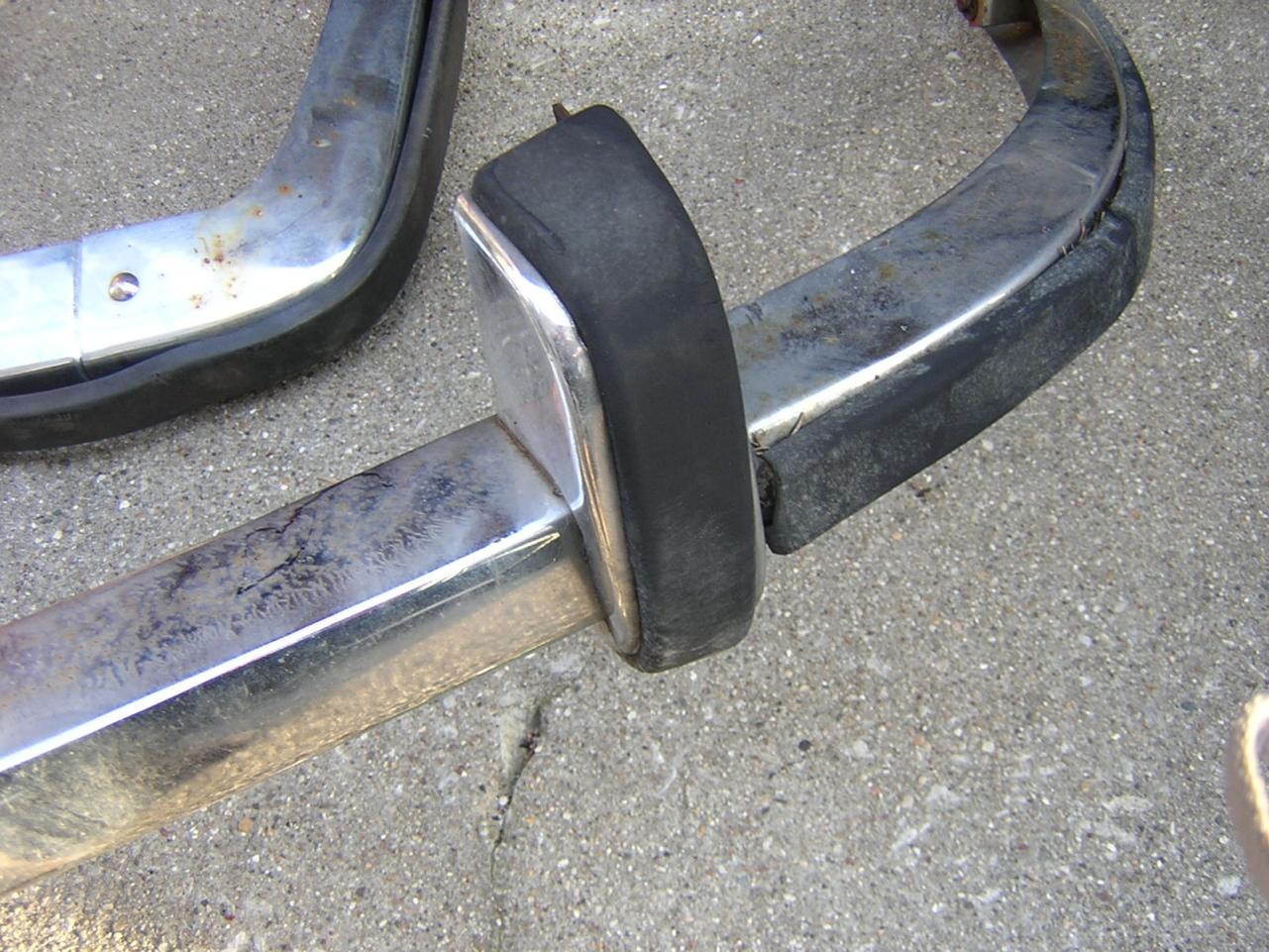

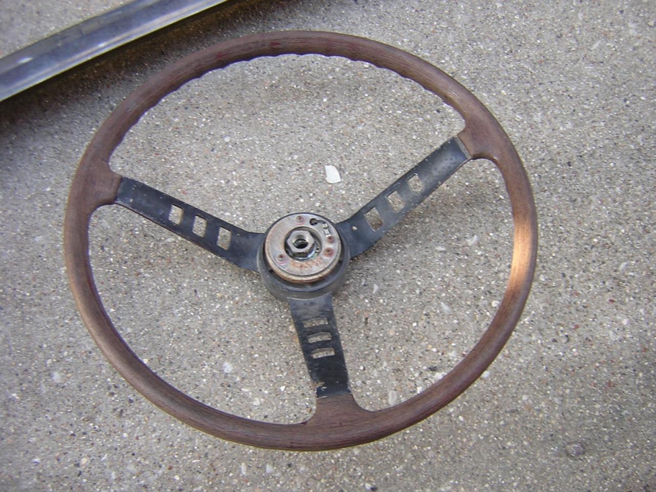

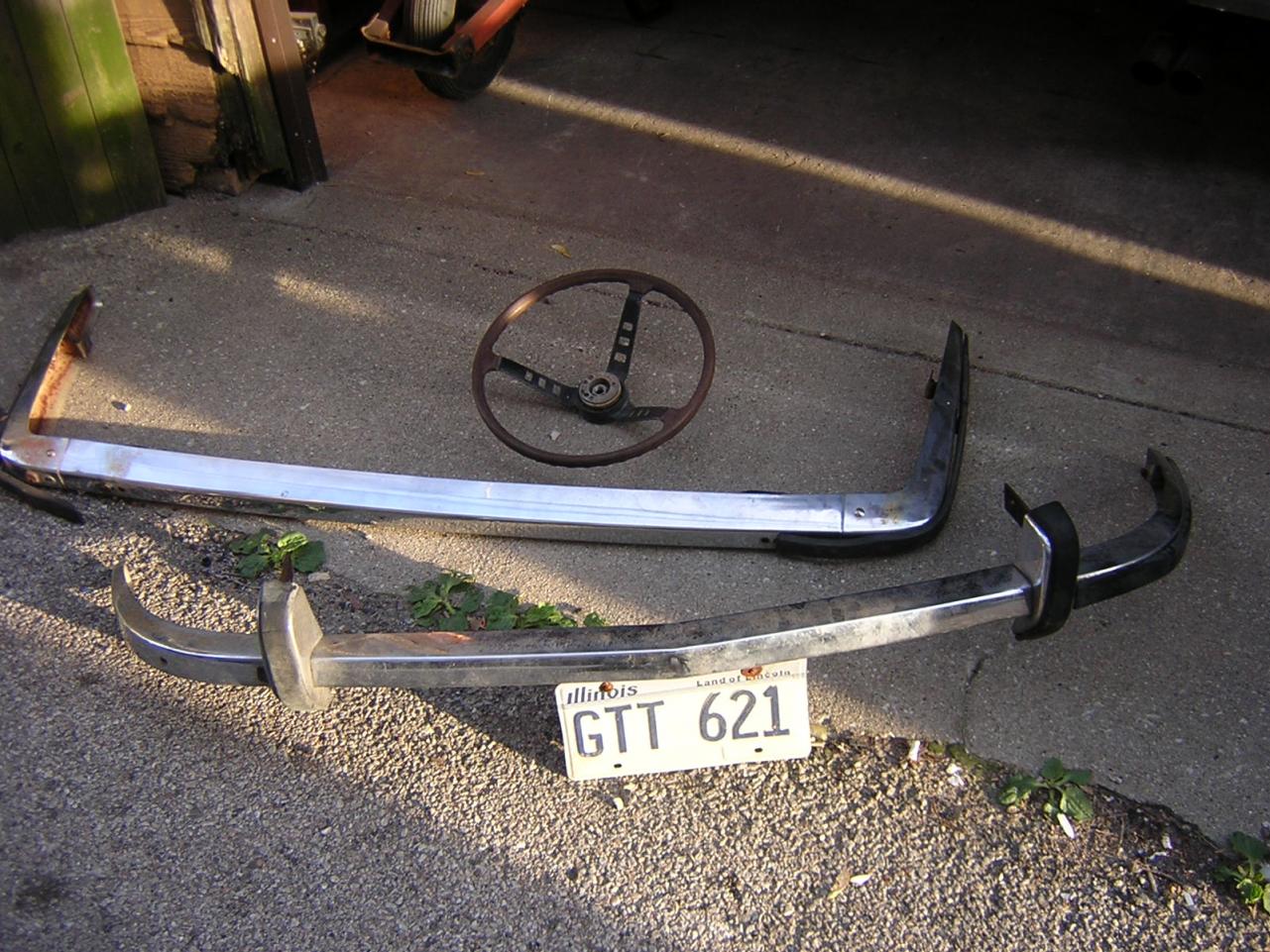

April 23, 201213 yr Author comment_387973 After filling the 4Runner with an obscene amount of tools, all I ended up using was some PB Blaster, a couple of sockets and one wrench. I was amazed at how easy the wheel came off (the puller was unnecessary, it just slid right off) and the bumpers didn't take long, either. The access panel was long gone on the donor car. Here are a couple of photos of the haul: The rear is missing the bumperettes and the rubbers are pretty much shot, but I think they'll clean up pretty well. The donor car didn't have much left on it, but the turning signal/headlamp controls were still there, as were the tach and speedo. All the glass looked pretty nice, as well, if anyone is on the hunt for those parts. I believe it was a 1972 240z. Thanks again for all the advice, guys. Link to comment https://www.classiczcars.com/forums/topic/42994-tools-needed-to-remove-a-71-240z-rear-bumper/#findComment-387973 Share on other sites More sharing options...
