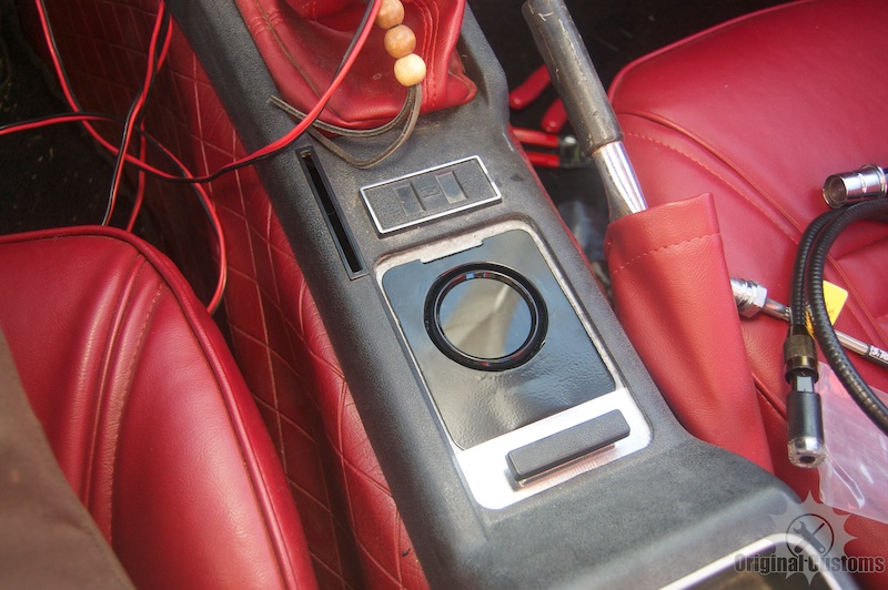

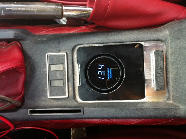

Perhaps I can add to the body of knowledge being assembled here. I am in Reno Nevada at 4500ft above sea-level. Ambient in August is a balmy 90+ degrees with 20% humidity. I was running extremely rich this spring when I got her running. (I just moved here). The following was my set up:
Idle jet 50F9
E-tube F11
Main jet 145
Air correction 170
Fuel pressure 2psi at idle
Brass floats set to 5.5
Mixture screws were 2 turns out
It ran pretty well with this set-up. But I do have an Innovate LM set up installed in the original ashtray so I can hide it when I want. I would start up and idle at 9.5:1 and pretty much never got much better than 13:1. I made the following changes and took it for a little cruise in the night air just a bit ago. It feels better but I imagine I will need to do some daytime testing and let her get warmed up to tell for sure.
Idle jet 50F8
E-tube F11 (stayed the same)
Main jet 140
Air correction 180
Fuel pressure 2psi at idle (stayed the same)
Brass floats set to 8
Mixture screws 1.5 turns out
I should mention, my carbs are 42 DCOE 8 triples not 40's. After a little drive this morning I find that I have developed a flat spot on tip in, especially aggressive tip in. But, my A:F numbers are much improved. It idles in the 11:1 range and except for when I drop the throttle, it stays in the 12 and 13:1 range. Drop throttle gets you 15:1 and there about... I have found some throttle response and power that wasn't there before which is really nice. Now, how to deal with the flat spot?
Thanks for the props on the install.
Edited by conedodger
