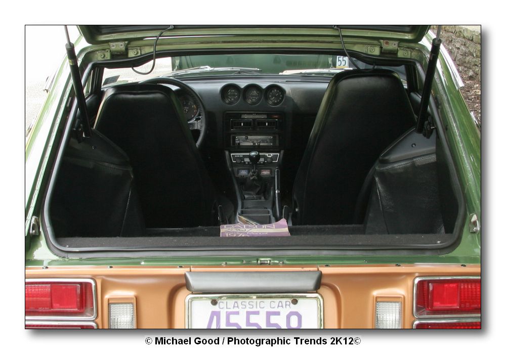

  mgood said:
Here is mine from a 76 - 280Z, The paint is not stock.
Almost looks like the rear panel matches the "butterscotch" interior color that came with the earlier 113 green cars. Very nice.
Looking at that picture I realized that the center piece isn't held on by the plate light screws, and it doesn't have rivets. I just repainted the outer panels on mine, and the plate light housing, but not the small center trim piece. Took a look at my car and it seems like it might clip on or have some other way to fasten it, underneath the plate light.
