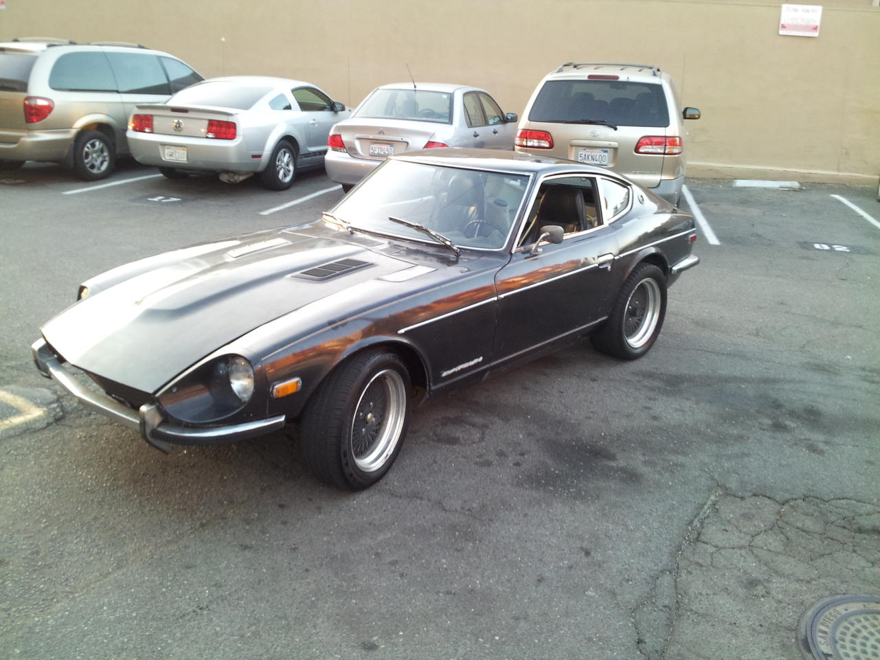

Thought I would start a thread in lieu of finally getting my 71 running this weekend!!!!
The car had been in a 5 year hiatus before I bought it, and due to other projects has sat for another 2 years while in my possession.
But on this memorial day weekend I was determined to get as much done as possible with the single goal of getting it going.

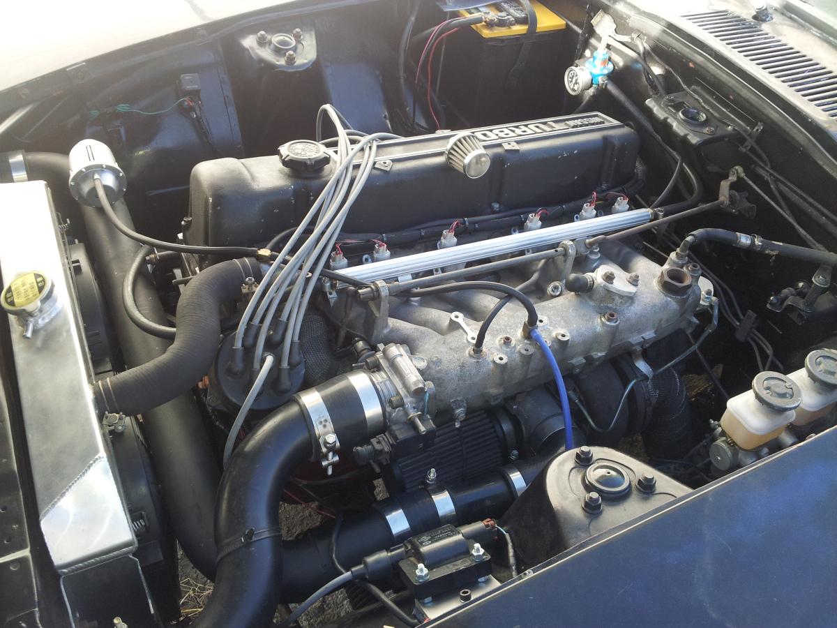

The car came with a l28 head l24 combo:sick:, which also happened to be missing a valve guide. The engine was swapped out for an l24 block early e88 head courtesy of CL.
I installed the engine a while back, had the SU's rebuilt, and toyed with ideas of elec ignition.
Yesterday, with everything hooked up, stock points distributor installed it started right up and rev'd great! Never mind the clould of smoke!
Today we installed the E12-80 distributor and did some further syncing of the the carbs. Idles really well,
Really happy with the progress! As any running Z gets the nod in my book :D:D

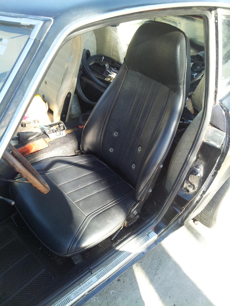

I pulled some seats from a 2+2 from the junk yard this weekend. Came to $19 each, with the half price day sale. I swapped out the rails, and put the drivers side in. Will work on the passenger side tomorrow. Much more comfortable. Happy with the results.
New tires were also mounted on the front, waiting on the rears.
those seats are a big improvement on the old white one you had in the first posts. Look neat and clean and a bargin too:cool:

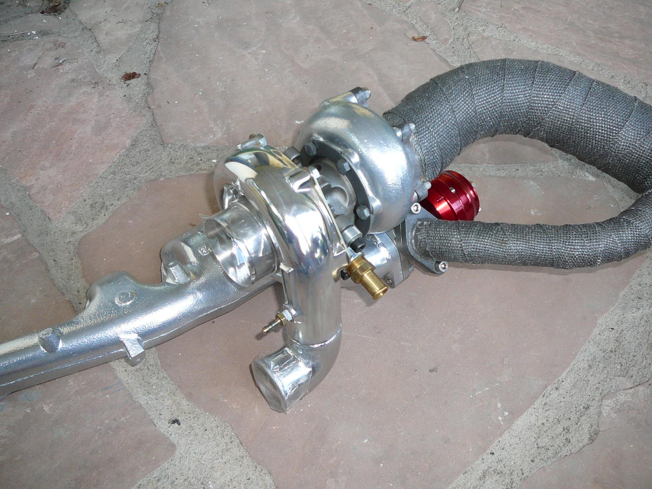

Its been a bit of a hiatus for the Z. The fuel tank is getting boiled and baffled. MSA down pipe also being installed, and some other fuel system upgrades (Fuel rail, Supra injectors, 044 fuel pump, FPR, etc). Will look to install this Turbonetics turbo at some point also.
