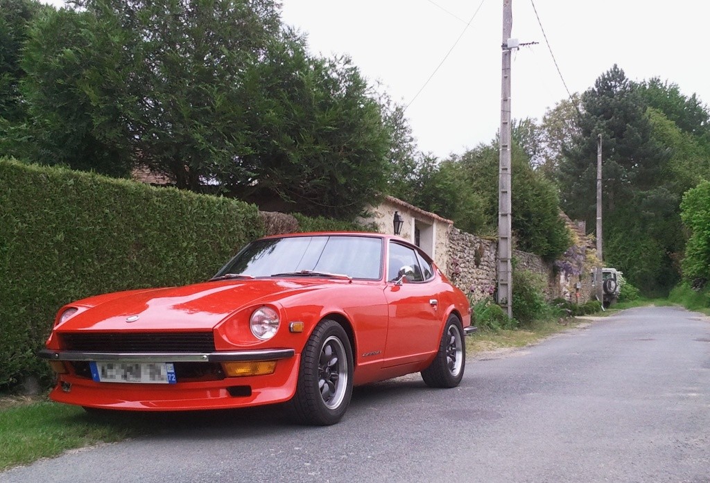

By the way, your avatar pic has planted the idea of that airdam in mind...
Good to hear. Let us know his feedback, I'll be curious to hear about it.
For the airdam, I love it. It is a xenon unit in polyurethane. It looks good but it is vey soft. Some reinforcements are required to make it efficient. Some brake ducts could also be added to create some functions to the form.
