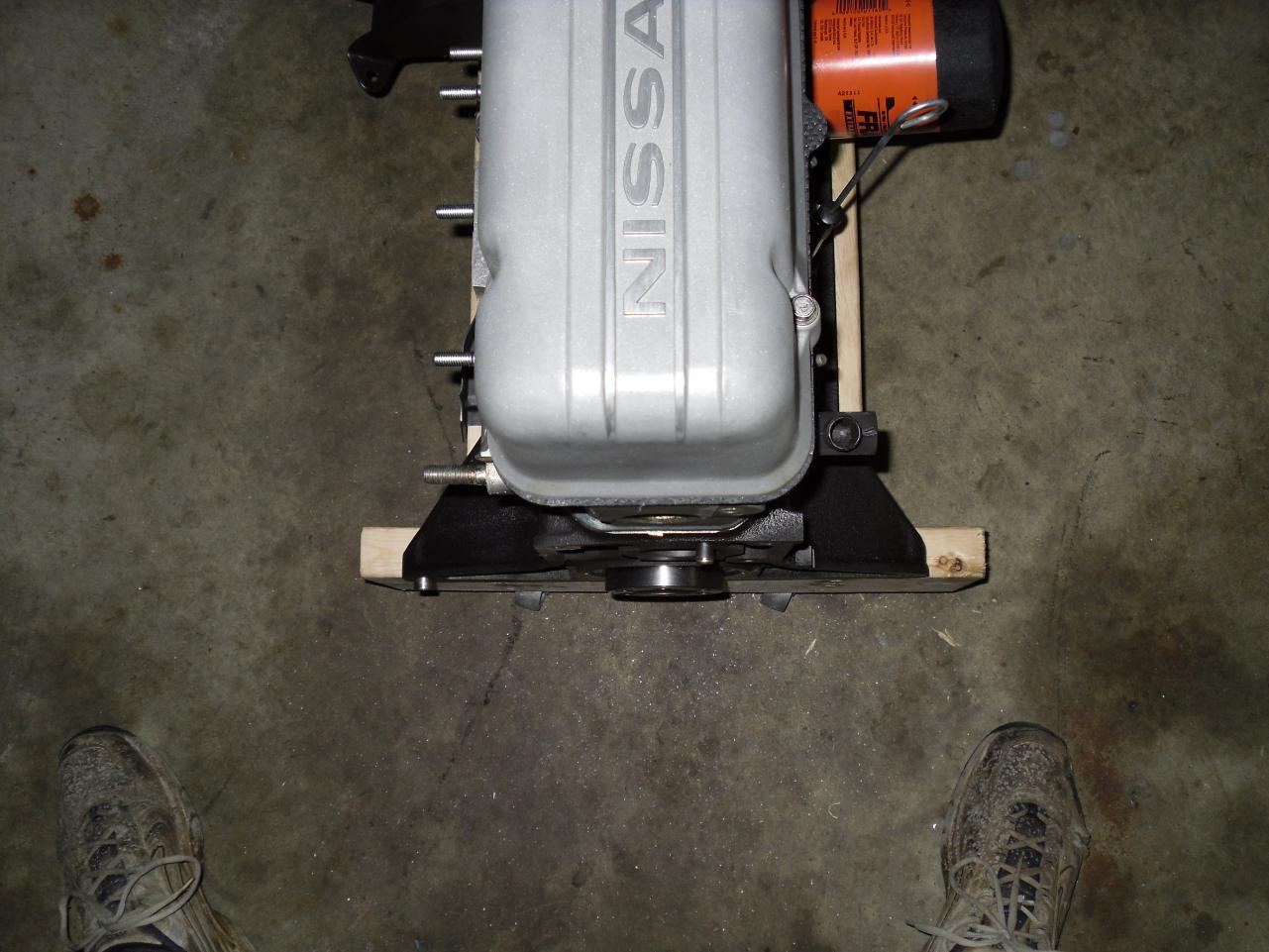

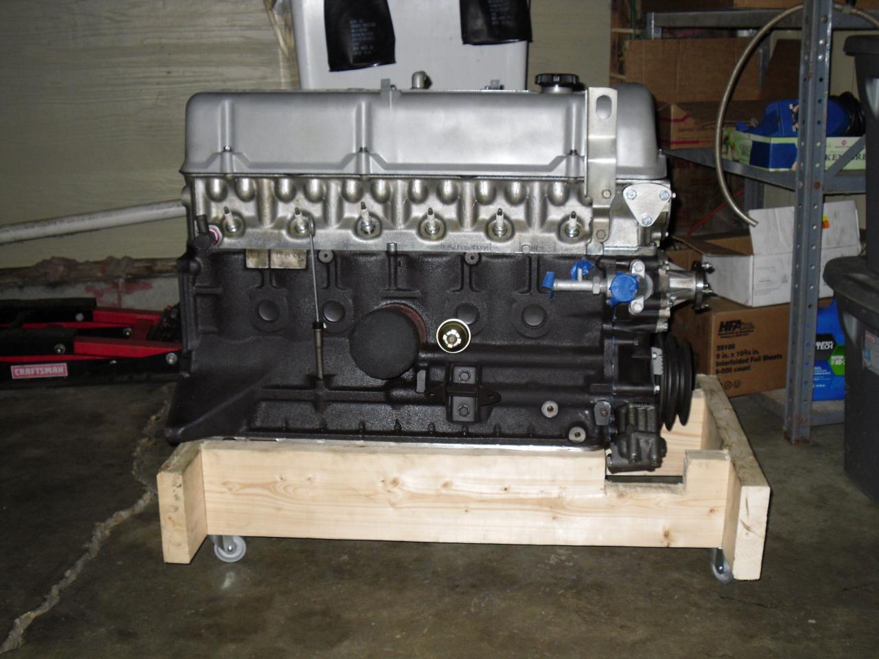

I've built the engine crate you put up measurments for. Works great but if someone (like me) is going to work on the rear of the motor, plate and flywheel, they should use 1x6 for the back side or do what I had to do with a wood chisel. The 2x is too thick to let the rear clear the board so I had to chisel out 3/4" of the thickness and went down about 2" so it will clear the rear board. You could still use the 2x but cut that out before nailing together. It sat about 1/2" short before I cut that out. But for storage it would be fine. And you'll have to go 1/2" farther back for the oil pump cut out.

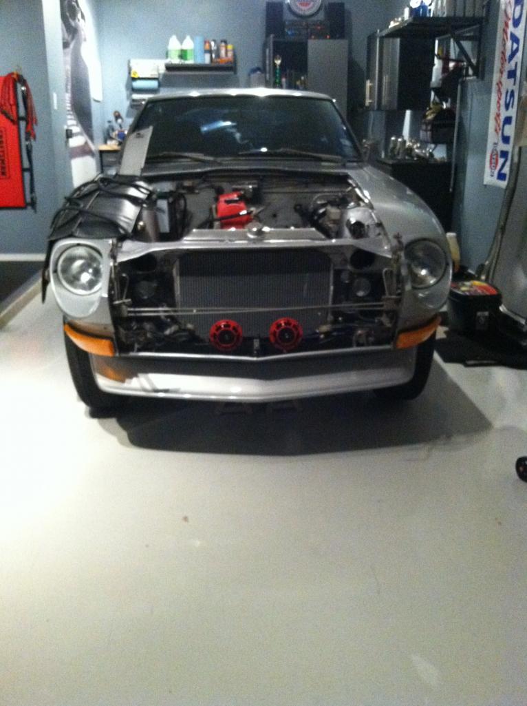

This evening I cleaned up the garage, put 1.5 quarts of royal purple in the transmission, hooked up the speedometer cable, connected and tested the reverse lights, put the neutral switch plug back in, and installed the shiny new Hella Horns.
I am questioning the color of the horns.
What do you guys think?

I am questioning the color of the horns. What do you guys think?
I left in my original repainted horns and added a Hella Air Horn and mounted on the radiator support - extreme sound - very loud - it will get somebody's attention if needed (that's what a horn is all about).
