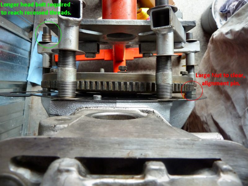

240260280z Posted June 23, 2012 Share #67 Posted June 23, 2012 An engine mount can be used to hold engine with flywheel. 3 short head bolts and 1 long head bolt with iron pipe nipples and washers works fine. Link to comment Share on other sites More sharing options...
Zedyone_kenobi Posted June 23, 2012 Author Share #68 Posted June 23, 2012 You know blue, it is just scary how you knew I was fighting with this just 2 hours ago. I was going to go get some spacers at the hardware store to do just this.Update. Hood is off today and I am getting ready to get her up on jack stands. WAAAY up on jackstands. Pics to follow. I will get those pics of the wooden block and I will take some measurements for you Captain. Link to comment Share on other sites More sharing options...
