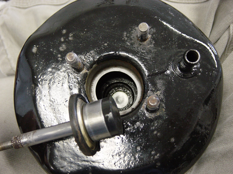

I'm pretty sure my reaction disk has slipped, this is based on reseaching on the site. I have a question, Do I have to take the brake booster off to try and repair or can I attempt to fix with it still on the car. It's a 73 240

You can pull the master cylinder off then pull out the seal and push rod with the booster on the car.
Try to fish around inside on the bottom of the booster to get the reaction disk. It may be difficult with the internal spring. If you can't get it,either use a disc from another booster or take the booster apart.

I had the same problem. Took the booster off of the car and shook it and the reaction disk fell to the ground. Super glued it in place and now my
car stops perfectly.

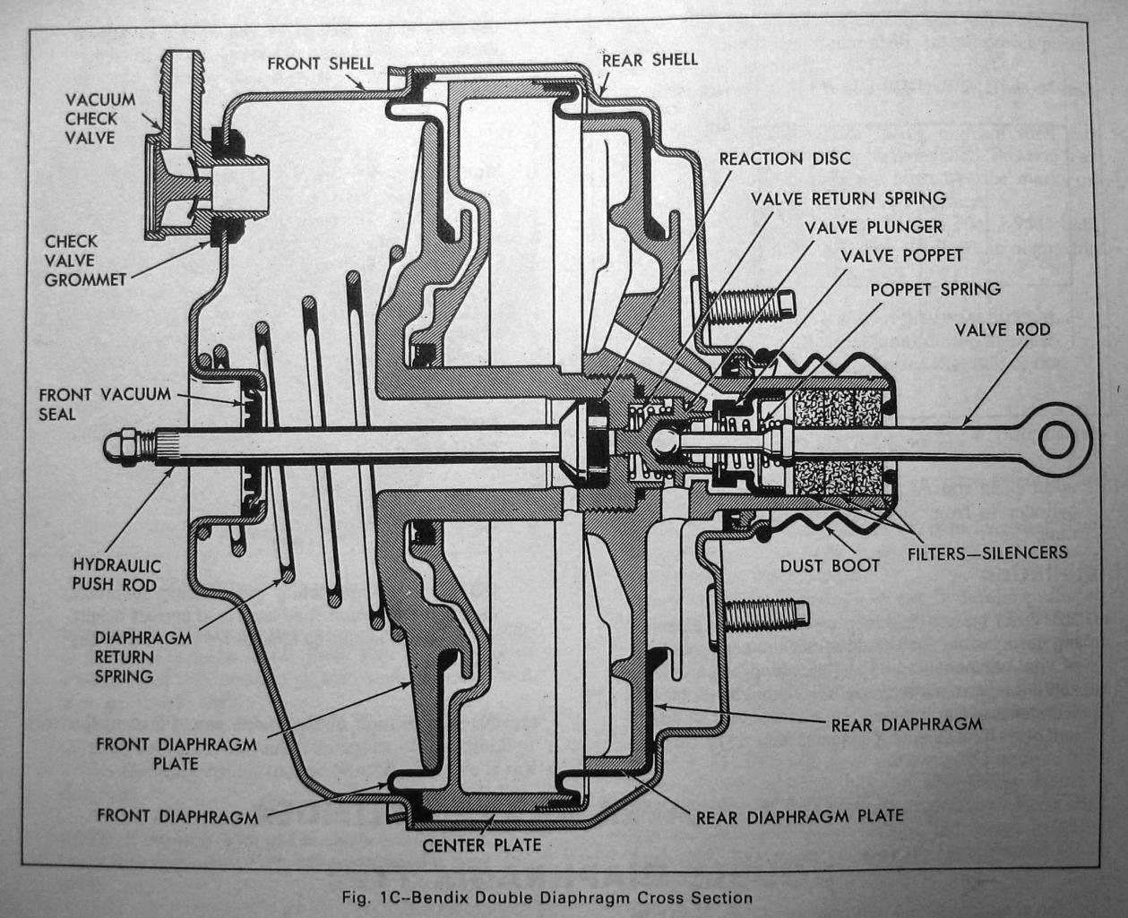

You should not use glue. Use grease instead to hold the disk in place while you reassemble the booster. The prodecure is described in the service manual.
Sorry Beerman but I don't agree. Give me one reason why grease is better than super glue. I had to pull my push rod out to adjust the rod recently (it was so tight, I had to put it in a vise). It was so nice not to have to have someone hold the brake pedal down so I wouldn't drop the disc again.....came out as a unit.....went back as a unit.
My primary concern is how the rubber will react to the adhesive. If it has a bad reaction the rubber could change. The reaction disk is a spring and is part of what determines how the Master-Vac reacts to pedal pressure. If the rubber changes the assist curve will change and change the feel of the brakes. Beyond that it is only the formality of following the factory's instructions.

Ok I left the booster on the car and got the pushrod out, no reaction disk but when I feel inside the hole where the rod goes it feels like a rubber disk is in the chamber where the rod goes. When the brake pedal is pushed it moves forward and back. Is it possible it was glued to the other end? I don't want to remove the booster from the firewall unless it becomes a last resort. I'm a big guy and have trouble getting in there to remove. Is there another rubber piece in the booster or do you think it is my disc.
