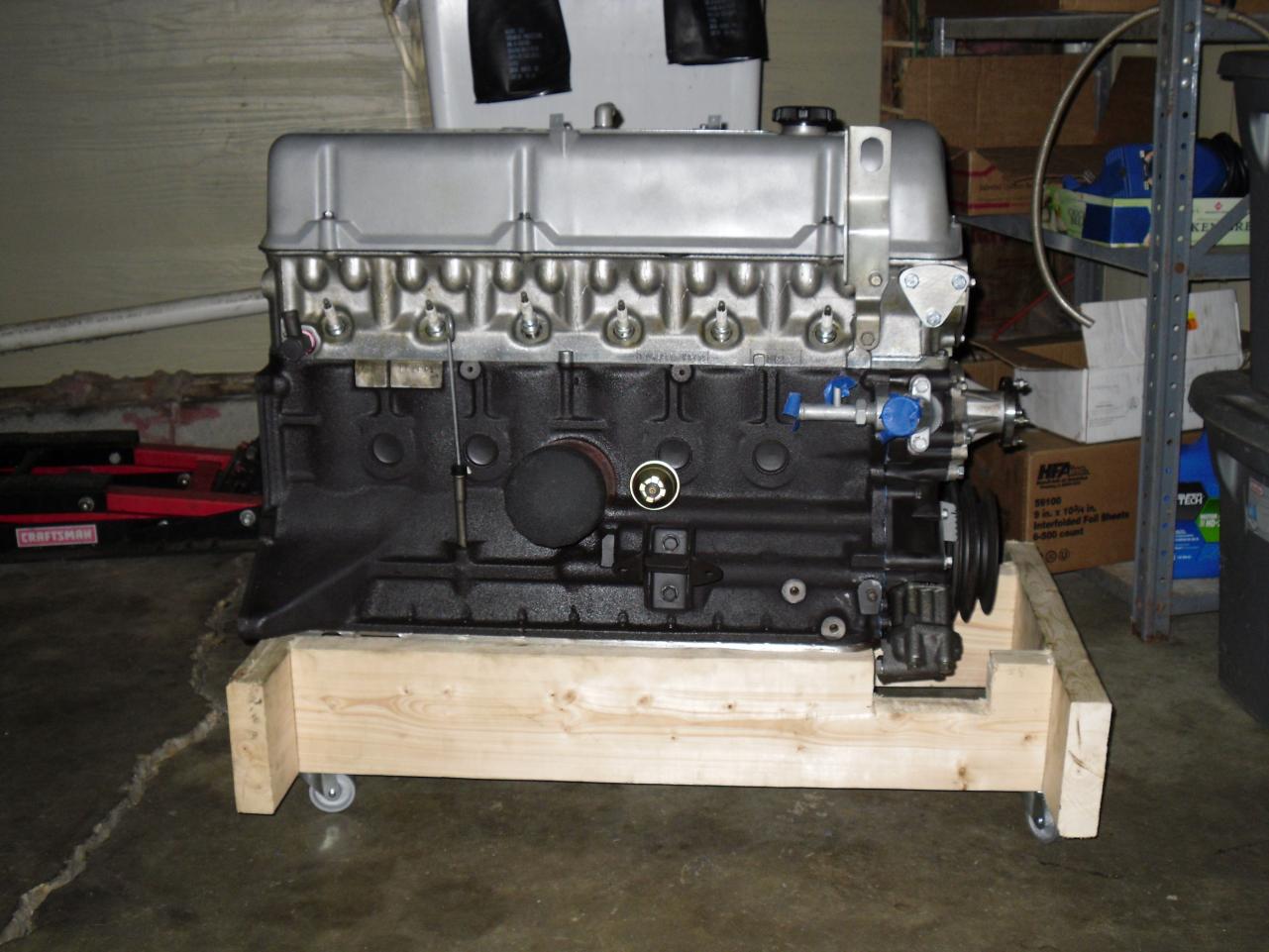

I promise that'll be one of my first post after it is running. Just got the clutch in and re-attached the tranny today so the motor's ready to be dropped in. I still need to solder the new connections for the injectors and cold start before i can crank it. Almost put the header on before mounting the transmission. In my crazy way of re-assembling that would have been a huge mistake because I'm doing it on the floor instead of hanging from a hoist. The bellhouse and transmission is a lot heavier than I thought, so glad I learned from you guys to pull both instead of bench pressing that b***h. Not really the floor but a crate Zedyone showed in his thread. It's taking longer than I thought because it's hotter than I thought it would be in HELL!
