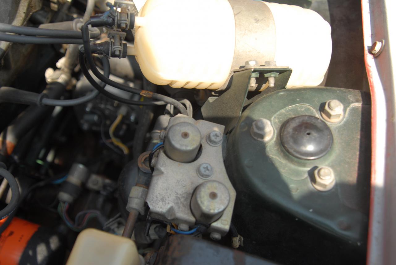

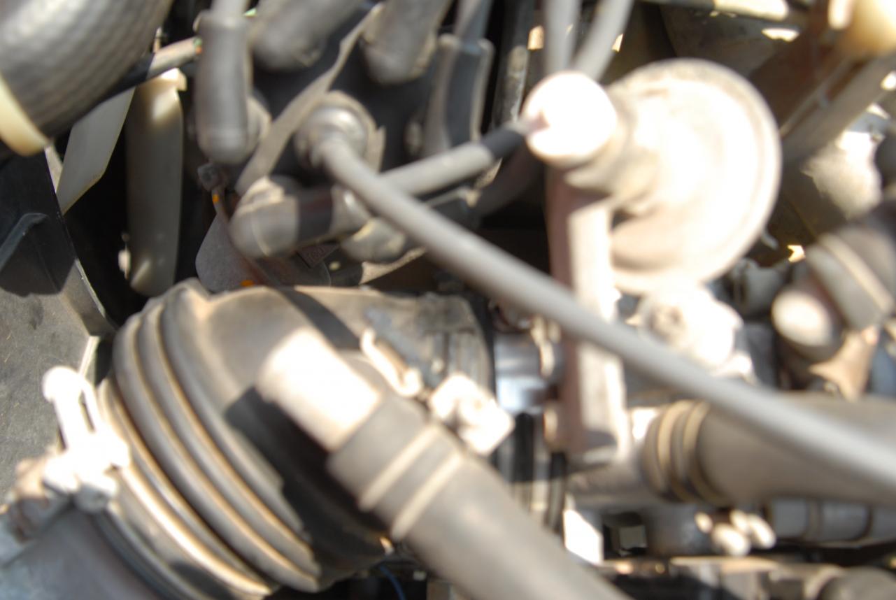

I have not had time to run any additional tests but will do so in the next couple days if not on the weekend. Extremely hot here. I did check out most of the hoses and did not find anything at least that I could see. Ok other than the boot between the AFM and TPS. I am attaching a photo which may be a little hard to see but the right end of the boot is taped with black electrical tape. Appears to be taped well but probably is covering a leak point. How significant could this be if at all? In addition could someone please tell me what the part is called and what it does in the second photo. There are a few small lines that are not connected and or damaged. Just a reminder I am learning.post-24101-14150819434601_thumb.jpg
I would think any leaks between the AFM and the throttle body would be of signifigance. Your AFM is measuring the amount of air going to the TB and you are sucking more air past the AFM that is NOT metered. You could try the old propane test and see if you are sucking air in that area. Some guys use carb cleaner to spray around possible leaks also. If you note any change then I would suspect that the tape is not holding or other cracks have formed.
Not sure what the second pic is
the second picture is for the heater controls, I forget there name. When power is supplied they open to allow vacuum to the vacuum selector behind the heat and fan controls. I believe there is a check valve somewhere in line before the vacuum canister.
The intake boots usually crack inside those accordian-like folds, so I'm skeptical the tape is covering a crack. But you never know. Pull off the tape and have a look! ;)
The little doodads in the second photo are called "magnet valves." One of them turns the vacuum on and off to your HVAC control systems. It sometimes goes bad, so people just bypass it without any ill effects. The other one switches vacuum on and off to the high idle actuator on your throttle linkage assembly. It's the thing mounted to your intake manifold with the hook on the end of it, which pulls against the tab on the side of the throttle linkage. This system is actuated along with the compressor when your A/C kicks in. Mine is fussy as hell, and it's almost impossible to adjust well. If yours doesn't work, I wouldn't worry about it too much. The engine can pull the compressor at a normal idle just fine. There's a diagram of how all the HVAC control tubing is connected in the heating/AC section of the FSM.

I know we are jumping from topic to topic here, but one thing that madkaw/fastwoman mentioned above - before adjusting your TPS and AFM - if that boot between the AFM/TB has a crack/leak in it, replace that before adjusting anything else especially if you think the car is running lean.
