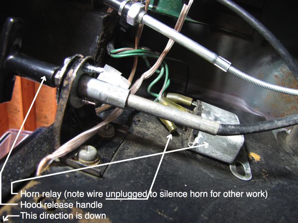

Zedyone_kenobi Posted July 13, 2012 Share #1 Posted July 13, 2012 My hell super tones have a relay that came with them. I would probably need to replace the OEM one for the Hella one, but I am not sure. Better to be safe than sorry. THE FSM says the relay is located "on the left side dash side panel" Is that near the hood release handle?Also has anybody else hooked these up? Did you use the Hella relay or the OEM one. Link to comment Share on other sites More sharing options...

Mikes Z car Posted April 28, 2013 Share #3 Posted April 28, 2013 Location of horn relay on a 1970 car, just above hood release. Link to comment Share on other sites More sharing options...
