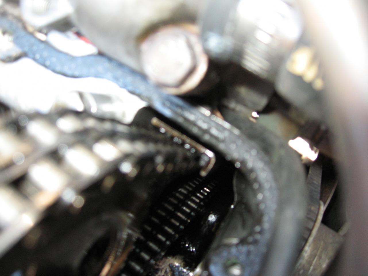

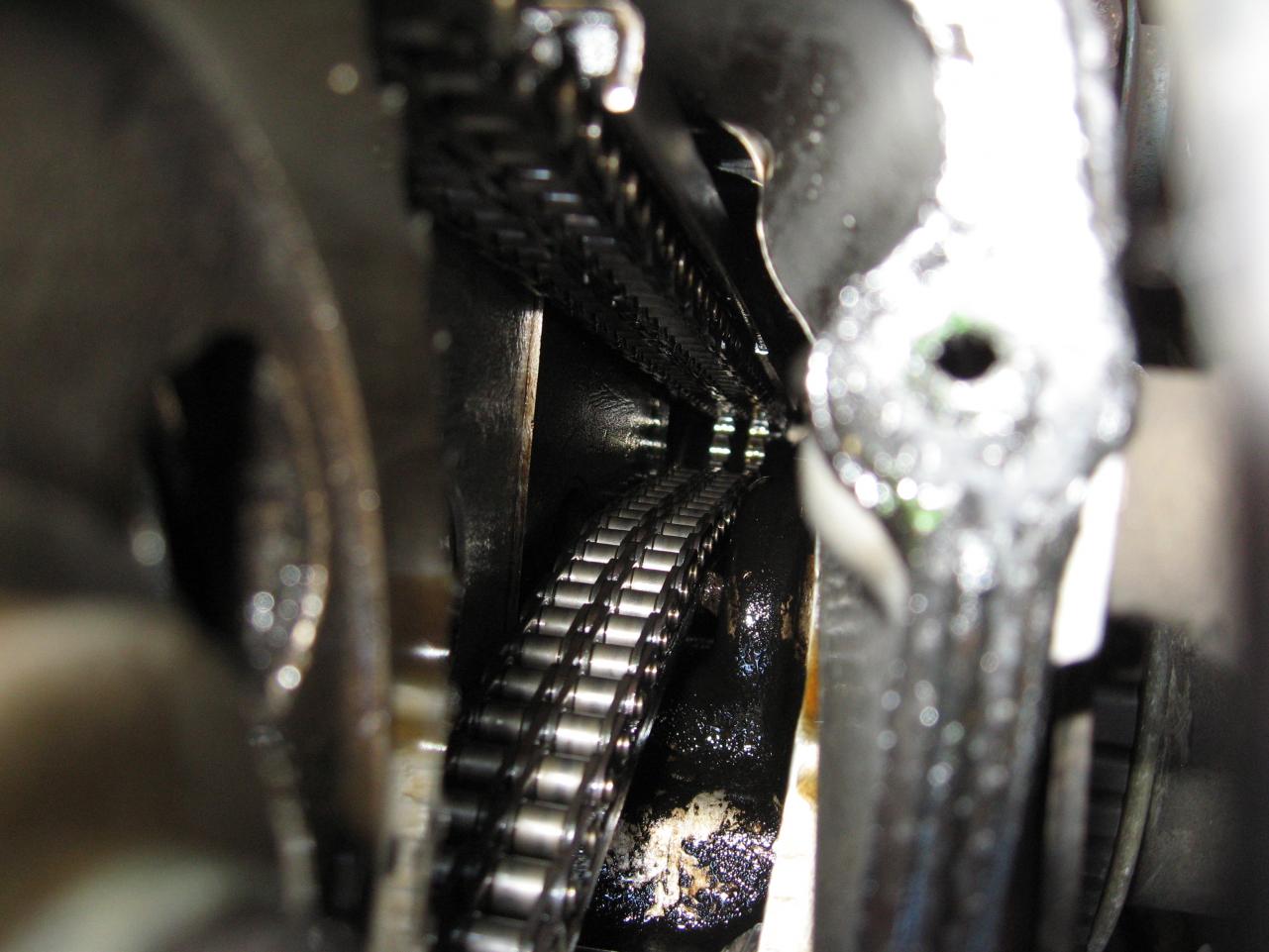

I also felt the tension on the chain. I can find no slack at all on ether side. It is really tight. Here are some photos of the chain and guides:
Sorry about the bad photography and I am sure the third photo is of little value, I took it mostly to see down inside further.

It dosn't sound like any valve train noise I have ever come across, sounds like the chain is draging on the tensioner or the guides. Can you see any marks or wear on the outter edge of the chain? Are there any marks on the inside of the valve cover, maby worth a look?

olzed makes a good point. I wonder if a long bolt was used on the front thermostat housing hole, pushing the guide in to the chain. In it's normal/proper position the straight guide, even with its plastic, doesn't touch the chain, except for the odd deceleration event when the slack might pile up in one spot. At least the ones I've seen.
Looks like your guide, sans plastic, is riding the chain all the time. I second (third?) the metal on metal making the noise.
I am now intrigued. Yes there is some plastic left on both guides, but worn way down. I guess I do not understand how any of the thermostat bolts could produce this situation. Hmmm. I think we are finding something. More exploration tomorrow.
