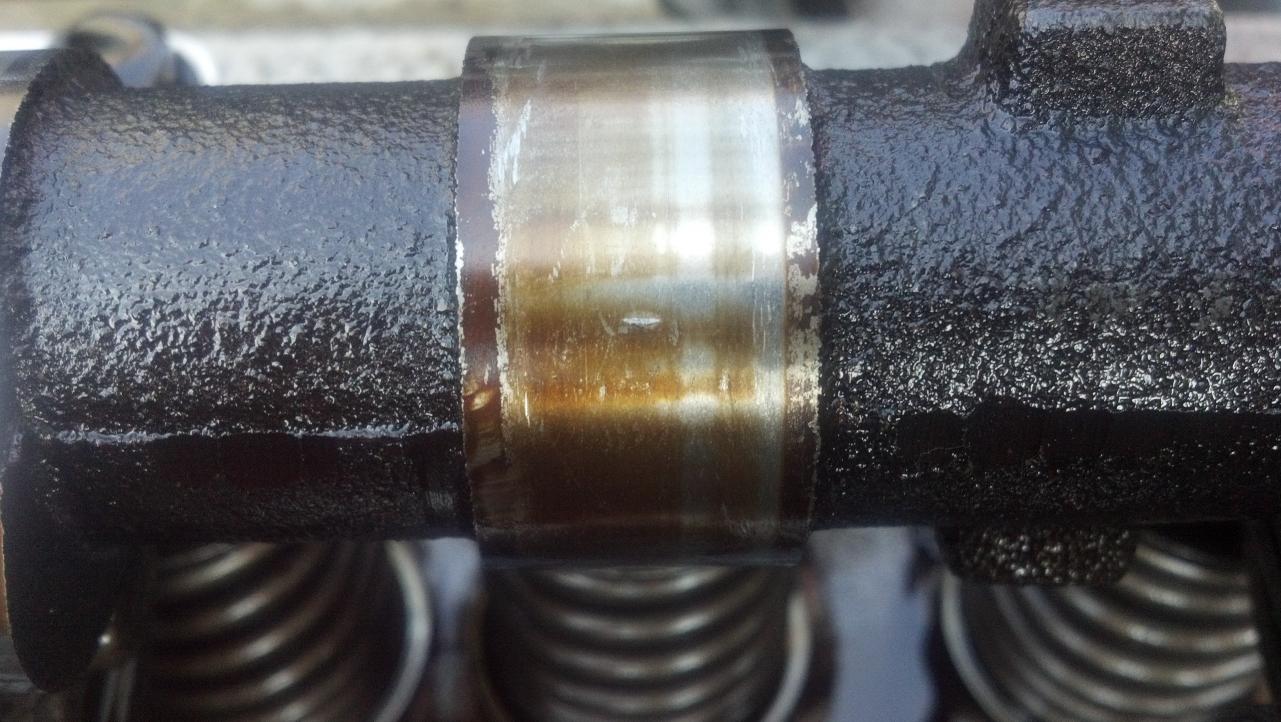

Posted July 14, 201212 yr comment_395754 well last night my rocker arms fell off and the cam has a slight scar on it i have a couple of questions. 1 dose the slight scar matter and if so what do i do? 2 i have 2 heads e88 and i have a n47 on the car its a 78 280z im not sure if there is any gain from that or can i just switch cams from one of the other heads im not sure what to do? yea i have a lot of problems the trans is also not shifting right but i still have to trouble shoot it but any ideas or in put is welcomed. just got it back from the body shop what a weekend Link to comment https://www.classiczcars.com/forums/topic/43810-rocker-arms-fell-off/ Share on other sites More sharing options...

July 14, 201212 yr Author comment_395761 well good thing you said something about putting them back where they went ill have to match wear patterns. but ok that takes that option out just wanted to know if i could do it im about to take some pics. slight as in i can feel it with my nail im going to come back with pics. i do need to ajust them they are all out of wack now. i really thought the thing was blown now if i can find someone to do a grind is that recomended? Link to comment https://www.classiczcars.com/forums/topic/43810-rocker-arms-fell-off/#findComment-395761 Share on other sites More sharing options...

July 14, 201212 yr comment_395772 It looks like your rockers are gouged. Can you turn them 90 degrees and take a picture? Link to comment https://www.classiczcars.com/forums/topic/43810-rocker-arms-fell-off/#findComment-395772 Share on other sites More sharing options...
July 14, 201212 yr Author comment_395773 it looks that way but its not like the cam i can't feel it with my nail or finger im guessing im going to want new rockers and pads. Link to comment https://www.classiczcars.com/forums/topic/43810-rocker-arms-fell-off/#findComment-395773 Share on other sites More sharing options...
July 14, 201212 yr comment_395774 Are you running a stock or performance camshaft? That lower rocker just doesn't look right. Link to comment https://www.classiczcars.com/forums/topic/43810-rocker-arms-fell-off/#findComment-395774 Share on other sites More sharing options...
July 14, 201212 yr Author comment_395775 everything is bone stock it dose look jacked up when you are looking at it but its smooth ive taken the oil off of it and same thing the cam i think is my main issue. Link to comment https://www.classiczcars.com/forums/topic/43810-rocker-arms-fell-off/#findComment-395775 Share on other sites More sharing options...
July 14, 201212 yr comment_395776 You can see the centered line on the top rocker, but the bottom rocker looks scalloped.......like it was adjusted too tight, improper rocker geometry or just plain wore out. How many miles on the valve train? Link to comment https://www.classiczcars.com/forums/topic/43810-rocker-arms-fell-off/#findComment-395776 Share on other sites More sharing options...
July 14, 201212 yr Author comment_395777 under 70k but my brother did the ajustment on it while i was in iraq so he might have done something wrong when he went with factory specs from the fsm that i have it ticked really bad then he did some digging and found other specs that stoped it from ticking but it did have a slight whin to it. Link to comment https://www.classiczcars.com/forums/topic/43810-rocker-arms-fell-off/#findComment-395777 Share on other sites More sharing options...
