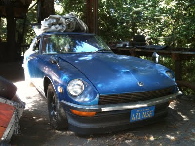

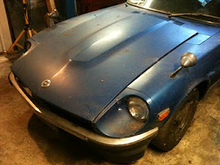

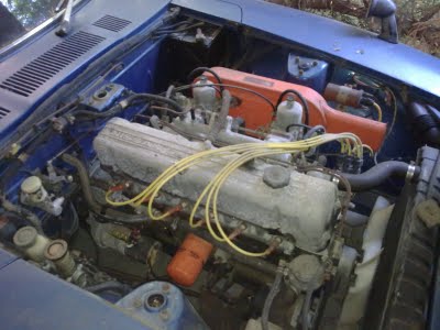

I am up for any suggestions and thanks for all your previous and ongoing help! I posted some pics of my new project so people can know what I am talking about. Any info or history a more experienced member would have on my particular car is greatly appreciated.

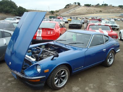

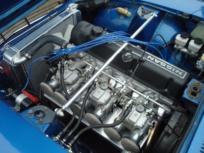

Your car seems to have quite low mileage, so honestly, I wouldn't bother with boiling the car right now unless you want to a Concours example. It is your car in the end, but if I were you I would buff out the paint with compound, treat the few rust spots, and DRIVE it. My Fairlady 240Z-L sat since 1992, I performed all of the above and it is daily drivable today. The paint was faded beyond belief, but I got a good shine out of it, just look at my attachments! It builds character! I do plan to restore it one day, but seeing as Fairlady's with original paint are a rare commodity, I do not mind waiting.
