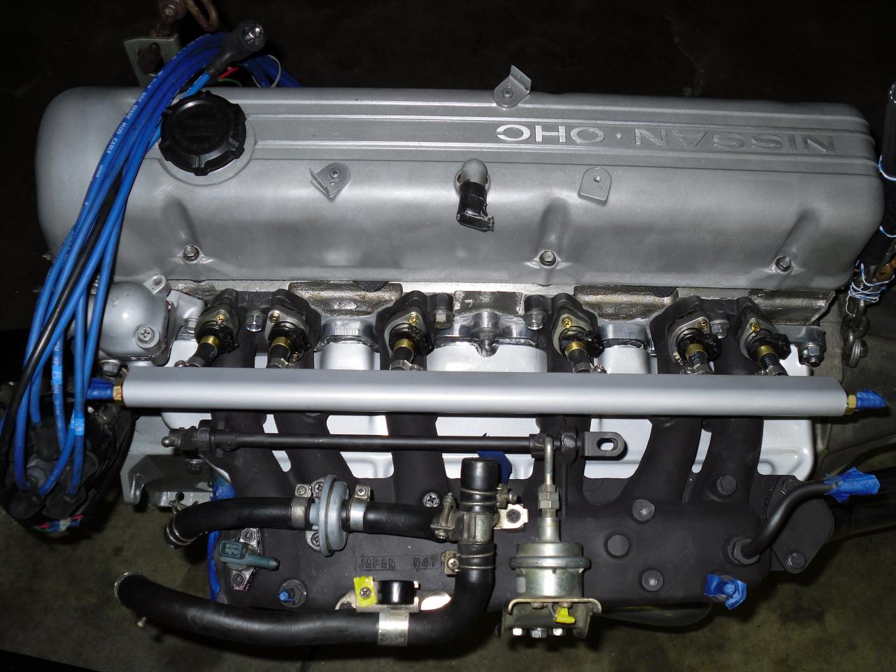

July 30, 201212 yr comment_397158 It looks great!Just a suggestion - You might want to find a different rear lifting point. Once the engine is in, that bolt is right at the firewall and will be hard to reach and remove. One of my engines was missing the factory lifting eye, so I was able to make one from some scrap steel. I think it was a Z distributor base plate, but I can't remember. Link to comment https://www.classiczcars.com/forums/topic/43955-alls-i-need/#findComment-397158 Share on other sites More sharing options...
July 30, 201212 yr comment_397168 Jeff has a good point. You can see what they look like here http://www.zzxdatsun.com/catRequests.php. Link to comment https://www.classiczcars.com/forums/topic/43955-alls-i-need/#findComment-397168 Share on other sites More sharing options...
July 30, 201212 yr comment_397172 Who needs the fat lady? I put my engine in by myself. Really not that hard. Just have to move slowly & carefully.I made a rear lift point from 1/8" aluminum. Did the stress calcs and it was plenty strong. Link to comment https://www.classiczcars.com/forums/topic/43955-alls-i-need/#findComment-397172 Share on other sites More sharing options...
July 30, 201212 yr Author comment_397187 I'll try and figure out something else, maybe a sling of some type. I'm kinda nervous picking up the engine with the rear exhaust stud. I don't like the idea of putting all that weight on the head. Thank you for the warning, I would never have considered that. Link to comment https://www.classiczcars.com/forums/topic/43955-alls-i-need/#findComment-397187 Share on other sites More sharing options...
July 30, 201212 yr comment_397195 I just pulled an engine and tranny combo a few days ago and attached at the exact same rear point that you did. I was able to connect a chain to that rear point while the engine and trans were still in the car, so you should be able to disconnect. It's a little tight, but it wasn't what I would consider "difficult". Worked for me, but YMMV. What I would worry about the most, however, would be scratching the paint on the firewall with the chain as you're jerking the engine around on final approach. Might want to drape a towel over the cowl and down the firewall while you're messing in there. PS - Your "All's I need..." reminds me of the "Send picture of boat and motor" joke. Link to comment https://www.classiczcars.com/forums/topic/43955-alls-i-need/#findComment-397195 Share on other sites More sharing options...
July 30, 201212 yr comment_397219 I'll try and figure out something else, maybe a sling of some type. I'm kinda nervous picking up the engine with the rear exhaust stud. I don't like the idea of putting all that weight on the head. Thank you for the warning, I would never have considered that.The combustion forces on the head are magnitudes greater than the static weight of the engine. Each head bolt can literally support tons, let along a few hundred pounds. Link to comment https://www.classiczcars.com/forums/topic/43955-alls-i-need/#findComment-397219 Share on other sites More sharing options...

July 30, 201212 yr comment_397244 I'll try and figure out something else, maybe a sling of some type. I'm kinda nervous picking up the engine with the rear exhaust stud. I don't like the idea of putting all that weight on the head. Thank you for the warning, I would never have considered that.I think I understand not wishing to mess with the manifold studs right after you've completed the build. I can totally in vision a sling working. Link to comment https://www.classiczcars.com/forums/topic/43955-alls-i-need/#findComment-397244 Share on other sites More sharing options...
July 30, 201212 yr comment_397248 The rear manifold stud is the manufacturer-deemed rear lifting point. I don't understand why there should be any hesitation to use it. Link to comment https://www.classiczcars.com/forums/topic/43955-alls-i-need/#findComment-397248 Share on other sites More sharing options...
July 30, 201212 yr comment_397250 The rear manifold stud is the manufacturer-deemed rear lifting point. I don't understand why there should be any hesitation to use it.Point taken. Link to comment https://www.classiczcars.com/forums/topic/43955-alls-i-need/#findComment-397250 Share on other sites More sharing options...
July 31, 201212 yr Author comment_397307 My hesitation is simple. This is the 3rd 280z I've owned and all of them had a serious leak on that particular stud. I'm sure it's a coincidence but I will err on the side of caution this time around. Thank you for the kind words Johnny Haywire. When I bought the car it would pull like a tractor and then fall flat on it's arse. I knew the potential was there and after looking around the www.com and reading everything I could, I started removing the engine. I've found all kinds of small problems that would have gone unnoticed had I continued driving the car. Now I know I have a good strong heart beat I can start putting lipstick on my little blue pig. Link to comment https://www.classiczcars.com/forums/topic/43955-alls-i-need/#findComment-397307 Share on other sites More sharing options...
