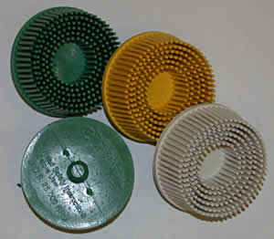

3M makes a godsend, they are the little roloc disks white, with little stubbles around the edges of the disk, made of plastic and they make an mandrel you can put in a rotary tool. I've used these things for years and really work great, most autobody shops carry them. They don't score the metal at all but they remove gasket like its nothing. The white is the finest i think 120 grit, its what i've been using.
I've used the Roloc's myself, but one word of caution, they CAN damage aluminum.
They are abrasive, and while it does take a bit of doing to do a lot of damage, on aluminum sometimes a bit is too much.
(Door/Sill Aluminum kick plates is where I used the white.)
But if you're careful, they are REALLY fast.
They also use the same adapter for the Scotchpad roloc discs.
