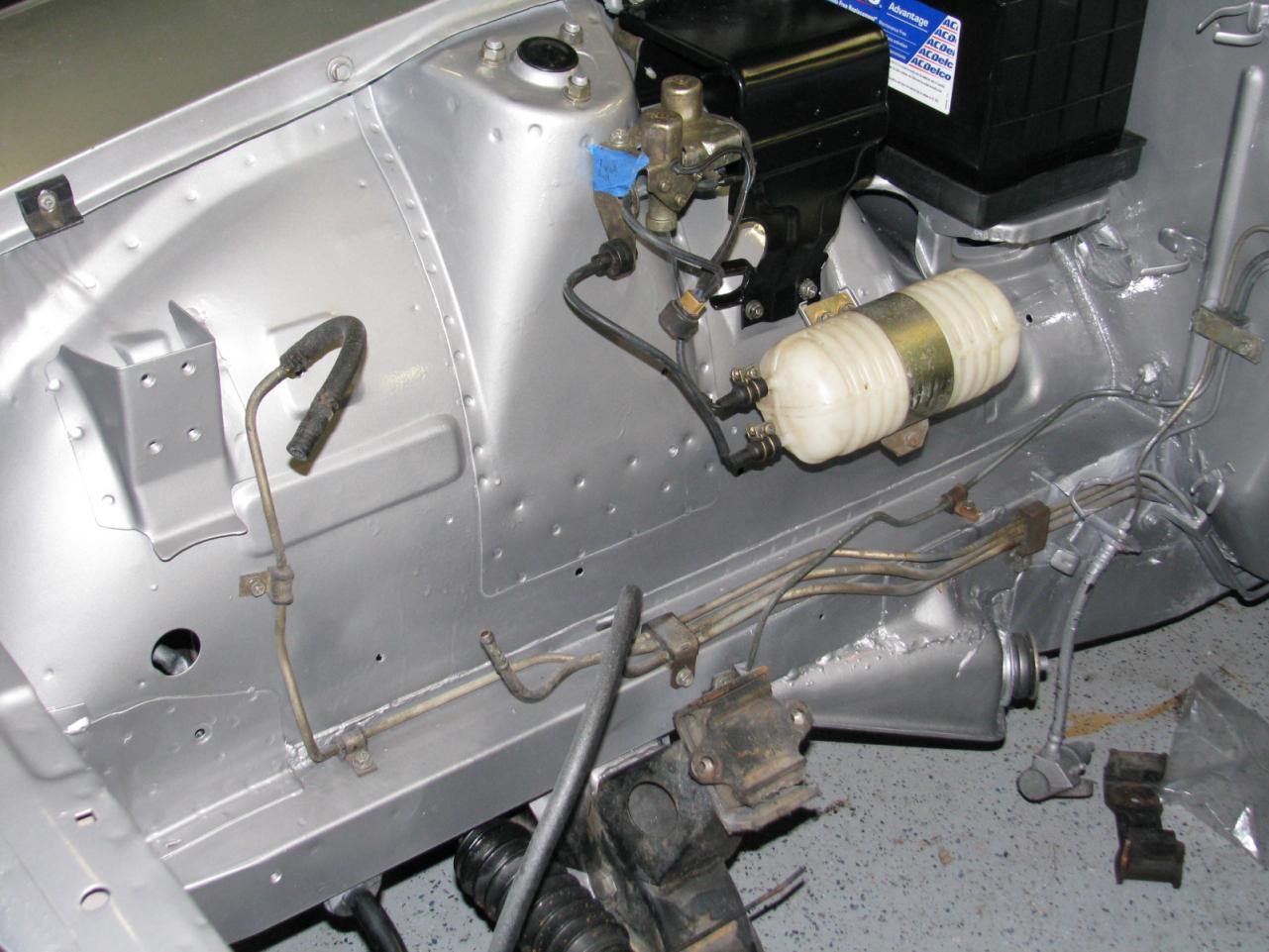

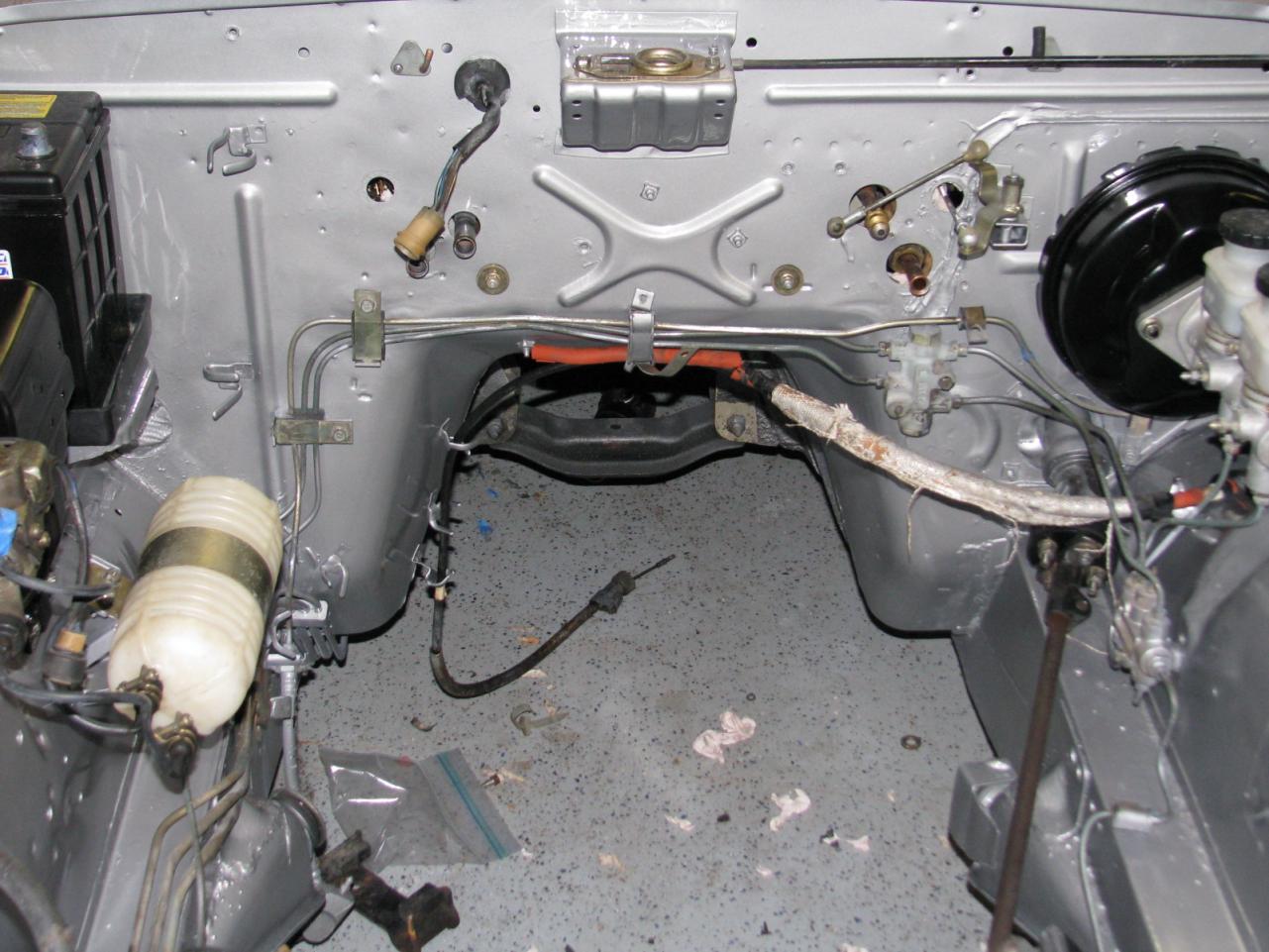

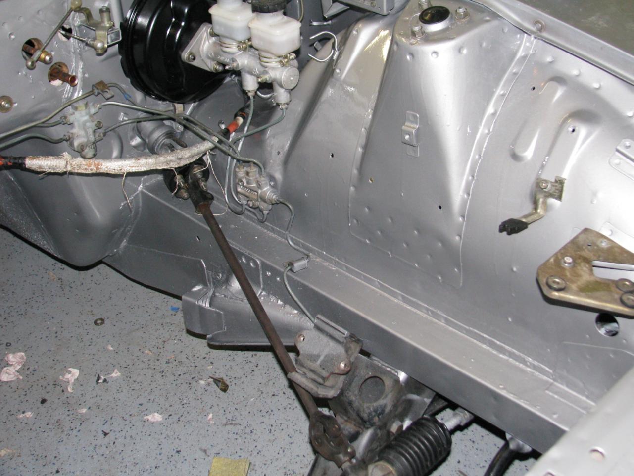

November 1, 201212 yr Author comment_405789 Long time, no post! A lot of down time waiting for parts... I mentioned before I was not entirely satisfied with my original paint match in the engine bay, it was too dark. I bought some paint from www.automotivetouchup.com Zedy had used them and if he was satisfied I knew I would be. I ordered 3 aerosol cans of 306, but only needed 2. I just had to rescuff the engine bay again, I didn't need to seal the enamel. I bought a cheapo Harbor Freight HVLP touch up gun and sprayed the clear conventionally. Urethane is the only way to go when it comes to paint. The color is obviously darker than my 1979 respray but is lighter by a few shades than the original color I sprayed. I also got a new booster and sprayed that. I have also been media blasting and painting small items like wiper arms, the little metal pieces around the firewall A/C lines and the tubes for the heater core. I also did the bracket that holds the voltage regulator and fusible links. I completely dissembled my grill and resprayed that and it is now back together. Before After The short block is together and I am now waiting on my rocker arms to come back from Delta Cams for resurfacing along with cam #4 since this project started. I have tried wrinkle coat painting the valve cover twice now and it still looks like crap! Followed VHT's instructions to the letter and no dice. Bought a used 240mm Turbo flywheel and it is at the machine shop being resurfaced. I am too loyal this machine shop, they have lost a head alignment dowel and one of my ball pivot inserts for the lash adjustment. Still need to either have my turbo rebuilt, or source a good used one. That is all for now, I don't think I will be done by Thanksgiving, just too many set backs especially with the cam. Edited November 1, 201212 yr by Ben's Z Link to comment https://www.classiczcars.com/forums/topic/44000-my-engine-build/?&page=5#findComment-405789 Share on other sites More sharing options...
