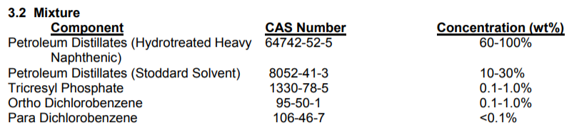

April 13, 20195 yr comment_573248 Diseazd said that his friend just fixed the tank (and replaced the fuel, I assume) . No mention of anything else. Marvel Mystery oil is basically just like gasoline, in solvent power. A good old Italian tuneup might do it. Just wear off the goo. http://www.marvelmysteryoil.com/media/1256/marvel-mystery-oil.pdf Link to comment https://www.classiczcars.com/forums/topic/44071-lash-pad-fell-off-top-of-valve-spring/?&page=3#findComment-573248 Share on other sites More sharing options...
