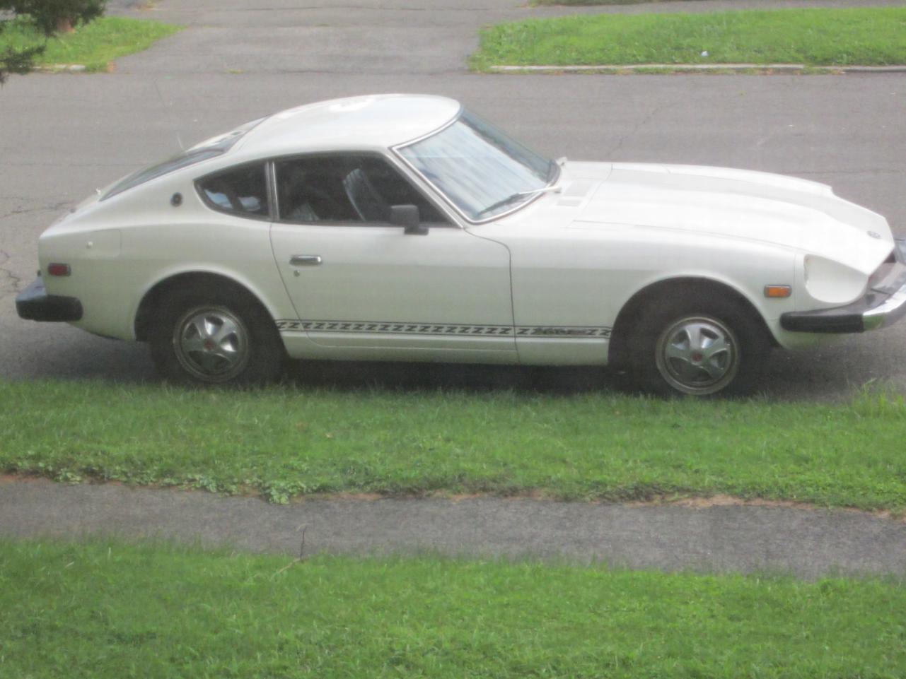

August 21, 201212 yr Author comment_399311 A picture I took earlier from inside my house through a dirty window Link to comment https://www.classiczcars.com/forums/topic/44150-how-to-get-260z-to-daily-driver-status/#findComment-399311 Share on other sites More sharing options...
August 21, 201212 yr comment_399312 Okay, from that picture we can tell you have a "late" 260Z. The bumpers are a dead give-away. You'll find it has a lot of parts in common with the 75 280Z. You might find that there are components in the engine bay that are in different locations from the FSM, too. What is the build date on the door jamb plate?Edit:The clicking sounds at higher speeds could be u-joints or loose bolts in the driveline. It would be good to check that out sooner than later.Check the fuses for your headlights. See if the bad headlight lights up when you switch it to bright.Like I said before, you could write a novel on getting a 40 year old car of unknown pedigree up to being a reliable daily driver.I tried to do that with my 73 about 20 years ago. That did not go well. I tried to do it on the cheap, and I didn't have near enough knowledge to get it in good shape. I'd actually have a better chance of getting the car in shape now. Edited August 21, 201212 yr by SteveJ Link to comment https://www.classiczcars.com/forums/topic/44150-how-to-get-260z-to-daily-driver-status/#findComment-399312 Share on other sites More sharing options...
