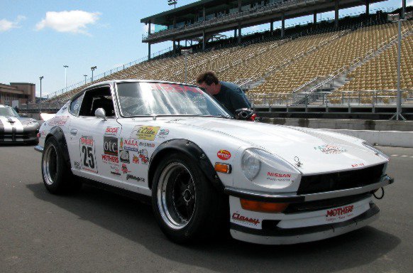

275/45-16s on 10" wide wheels look good under ZG flares.
Yeah, that looks perfect! So is that the same size all around? I was under the impression that you had to go staggered with the ZG flares? And any idea what offset those wheels are?
That's a good idea about using spacers to fine-tune the fitment. I don't know why, but I've always been a little...I dunno...paranoid about running spacers though. I know they're probably totally safe, but I've just heard horror stories about them cracking...not what you want. LOL
For best handling you want the same size all around. The rims were custom with 5.75" of backspace. Offset doesn't matter. On the car in the picture I've run spacers up to 1" think on the front at speeds over 140mph without any problems.
