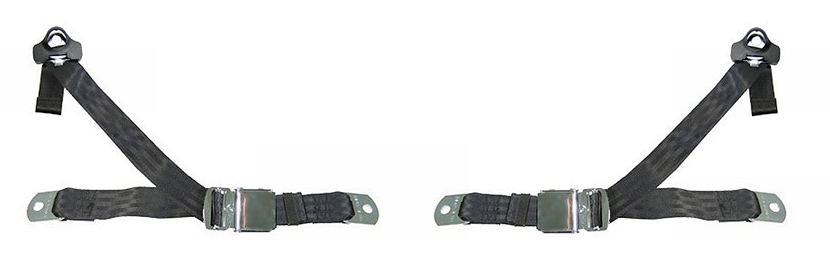

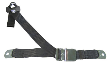

October 17, 201212 yr comment_404502 $37 (each) Alternative: http://www.seatbeltsplus.com/product/CH300.html Link to comment https://www.classiczcars.com/forums/topic/44189-seat-belts-refurb/#findComment-404502 Share on other sites More sharing options...
October 17, 201212 yr comment_404508 http://www.ssnake-oyl.com/First class services and product. Don't skimp ($) on your safety equipment! Link to comment https://www.classiczcars.com/forums/topic/44189-seat-belts-refurb/#findComment-404508 Share on other sites More sharing options...
