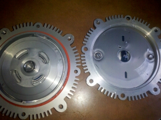

I have the clutch removed from the fan atm was going to try to rebuild, however mine is bolted to the fan, I removed the 4 bolts, but then the fan is riveted together where rebuild instructions say there should be 4 bolts....
Is this clutch not able to be serviced?
Also no fan clutch on my early 74 260z, havent had one since I have had the car, I assume this is typical of the year and model?
Edited by boosd
EDIT, Drilled rivets out, I guess this is an aftermarket fan clutch????
Looks pretty good though.... So im guessing this isnt the issue?? [ATTACH=CONFIG]55783[/ATTACH]
Its hard to tell from the picture if there was any oil inside the clutch, and if there was oil in it, was it thick?
No oil or too thin oil and it won't work very well regardless how it looks inside.
They riveted the halves together? I've never seen a factory datsun clutch thats rivited. There is no way to put it back together unless you put threads in one half with a tap but thats too much trouble. I'de just get a used factory datsun clutch off someone and add a heavier oil to it.
