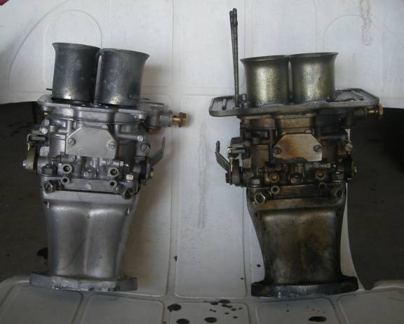

It's still too cold to try the lemon juice soup on the BBQ so I am trying another interesting carb degreaser: Pine-Sol.
A Datsun 510 DAF-328 carb is now soaking in my basement.
Have a look at this thread: The Pine Sol Degreaser Thread - ADVrider

Well I am not impressed. I soaked for a few hours and it worked nicely at removing the crud and varnish.
I let sit for another 24hrs and it removed a lot of cad/zinc plating and darkened the aluminum. I guess it is just an acid like any other.
When I disassembled the carb it was messy and gooey in the internal passages and the brass jets and fittings darkened.
It was ok after spraying with carb cleaner and oiling the iron base of the DAF328
Bottom line: I feel dumb as the fools that post this BS on the net.
It is amazing that many just soak in the Pine-Sol and don't even take the carbs apart afterwards.
I do not recommend this.
I have a Weber DGV that I will boil in soapy water and see what happens. Stay away from acids unless you plan to replate the cad/zinc!!!!
Edited by Blue

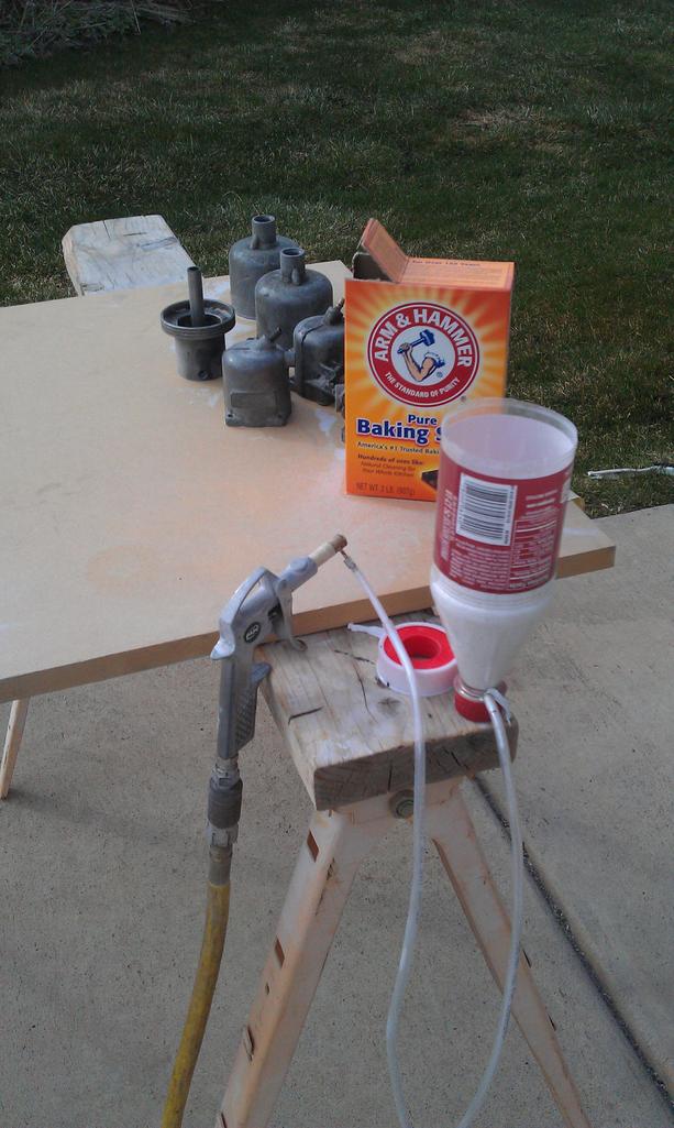

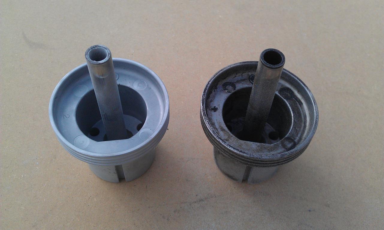

  putmattaway said:
[ATTACH=CONFIG]62463[/ATTACH][ATTACH=CONFIG]62464[/ATTACH]
I rigged up a baking soda blaster with stuff I had laying around. It cuts right through the carbon deposits.
I bought an abrasive blaster at Tractor Supply. I just have to get around to trying it out.
