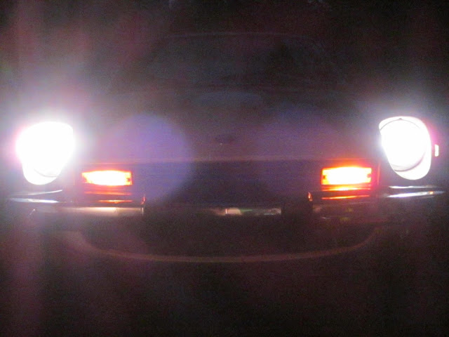

Turns out that one of my replacement fuses was a bad one. The right headlight just needed a fuse, the left needed a new bulb. I threw the ones I got off of eBay in and after hours of messing with the assemblies, I got everything back together and in place.
I threw them in there before the harness for emergency situations where I have to drive when it starts getting darker. I forgot to mention that only my high beams are working, but I havent searched for a solution for that yet. I take it the MSA headlight harness wont work at all in my 74 260?
