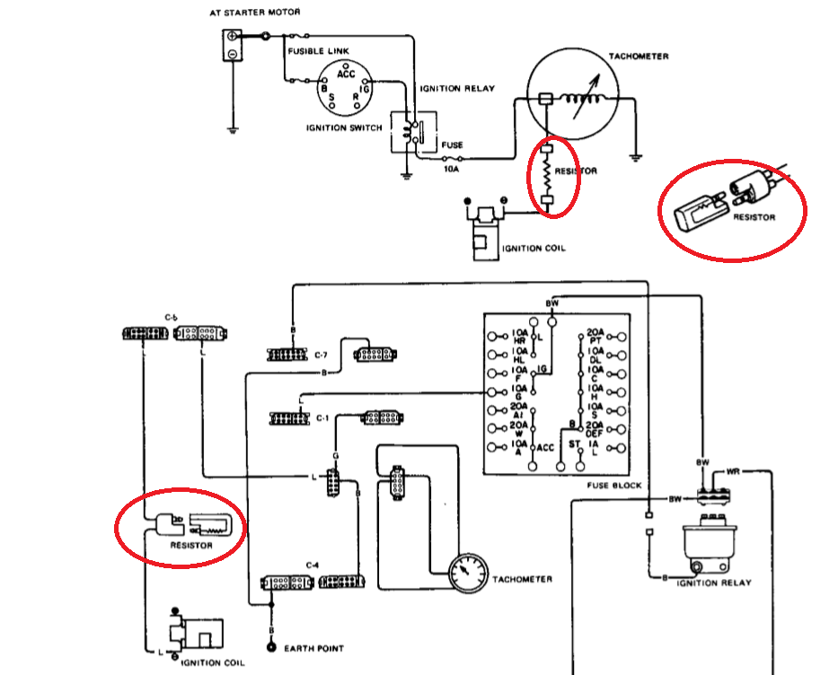

There is a 2200 ohm resistor in line with the line between the negative coil terminal and the tach signal pin. Here it is in the 76 FSM.
Now it would appear from the above discussions that many have not had a problem with getting the tach to work without it, so maybe it doesn't matter, but in the case where you have trouble, adding it might help.

I'm with you all the way Captain. I know I had a schematic of the 280 Tach , but can't find it. Curiosity has the best of me and I went back and looked at the U-tube of the mod on the 5 ohm resistor. I can't be 100% positive , but what I see is a 22k  resistor that  was shorted by the jumper. That would make a lot more sense that eliminating a 5 ohm resistor and the tack started working.
I also didn't realize that there was a resistor in line on the 280 tach . I pulled my 75 schematic and it shows the resistor , but no value. Now I'm going to have get under the dash and locate that elusive resistor.
It's a lump in the tape of the harness.  It's shaped just like the picture.  It's in the vicinity of the ignition module.
If too much current flows through the tachometer the coil might not discharge.  Make then break.  No break, no spark.  Maybe why it's 2200 ohms.
