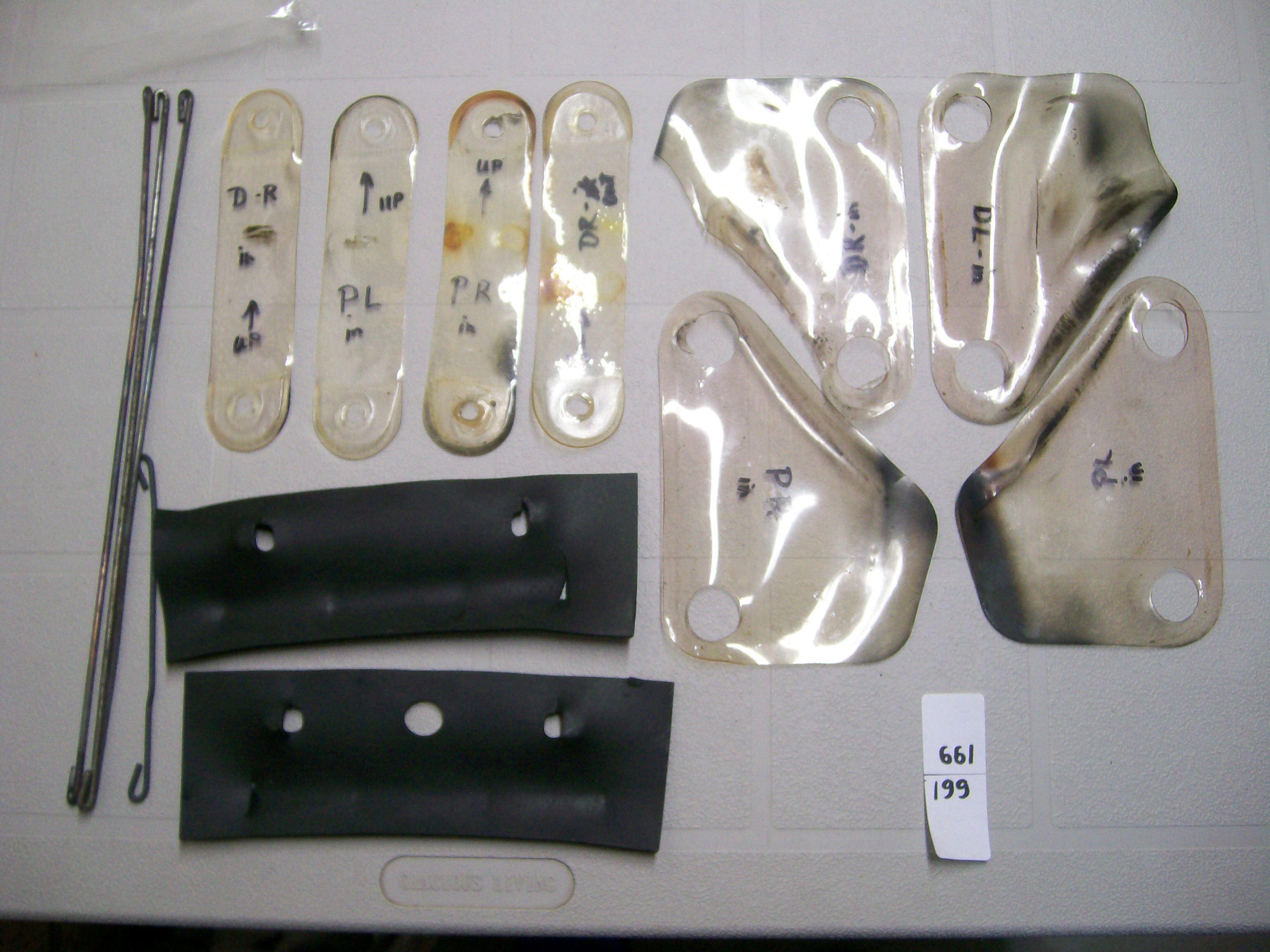

April 27, 2024Apr 27 comment_664526 Looks good. Did you install the clear plastic protector between the seat side brackets and the upholstery? Keith Link to comment https://www.classiczcars.com/forums/topic/44331-diy-how-to-recover-your-z-seats-lots-of-pictures/?&page=5#findComment-664526 Share on other sites More sharing options...

April 28, 2024Apr 28 comment_664568 On 4/27/2024 at 2:39 AM, zed2 said: Did you install the clear plastic protector between the seat side brackets and the upholstery I did. The originals, although intact, were stiff and discoloured. I found some clear vinyl sheet of suitable thickness and made new ones, using the old protectors as templates. Edited April 28, 2024Apr 28 by Namerow add photo Link to comment https://www.classiczcars.com/forums/topic/44331-diy-how-to-recover-your-z-seats-lots-of-pictures/?&page=5#findComment-664568 Share on other sites More sharing options...

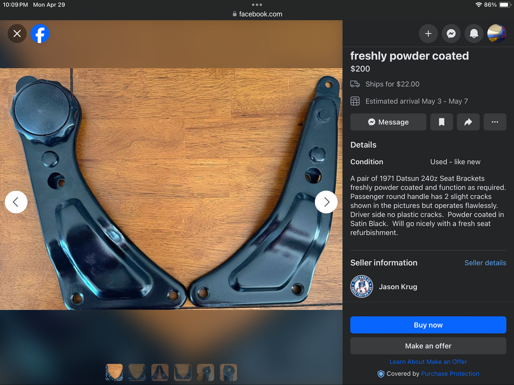

April 30, 2024Apr 30 comment_664685 On 4/27/2024 at 11:53 AM, Captain Obvious said: Gotcha, thanks. So that indicates an issue for me.... Someone in the past has replaced my LH seat with a RH seat. Probably because the original LH seat was worn and it was simpler / easier to find an un-worn RH seat (in the US). So now it sounds like I should find a LH seat. Here is a pair of seat side brackets: Keith Link to comment https://www.classiczcars.com/forums/topic/44331-diy-how-to-recover-your-z-seats-lots-of-pictures/?&page=5#findComment-664685 Share on other sites More sharing options...
April 30, 2024Apr 30 comment_664703 Thanks @zed2. Those seat brackets sure are clean and shiny!! Link to comment https://www.classiczcars.com/forums/topic/44331-diy-how-to-recover-your-z-seats-lots-of-pictures/?&page=5#findComment-664703 Share on other sites More sharing options...
