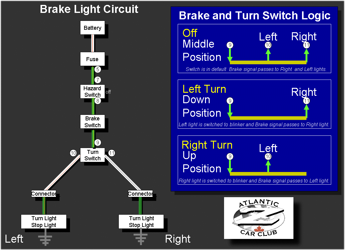

Posted September 14, 201212 yr comment_401620 Schematic for Brake Light Path (not turn light path and not hazard path) Link to comment https://www.classiczcars.com/forums/topic/44407-71-240z-brake-light-circuit/ Share on other sites More sharing options...
