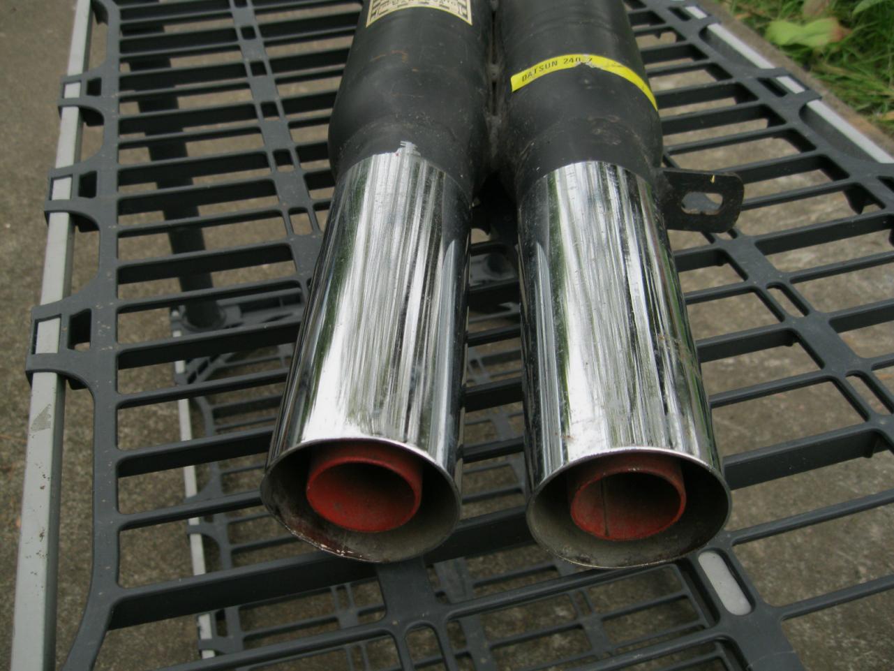

September 29, 201212 yr comment_402890 http://www.ebay.com/itm/1970-71-72-73-Datsun-240z-Fairlady-Z-Mirmitte-Dual-Muffler-RARE-/110956180305?pt=Motors_Car_Truck_Parts_Accessories&fits=Model%3A240Z&hash=item19d580f351&vxp=mtr Here a very nice/rare muffler........Ahhh! Vintage Supersprint. Very nice indeed. Link to comment https://www.classiczcars.com/forums/topic/44410-what-is-the-most-stock-sounding-exhaust/?&page=2#findComment-402890 Share on other sites More sharing options...
September 29, 201212 yr comment_402892 But don't you have to cut the opening in the lower rear panel - wider - to mount the side by side? I would think that kind of limits the market for it.FWIW,Carl B. Link to comment https://www.classiczcars.com/forums/topic/44410-what-is-the-most-stock-sounding-exhaust/?&page=2#findComment-402892 Share on other sites More sharing options...
September 29, 201212 yr comment_402895 Back in the day it was a popular mod..................... Link to comment https://www.classiczcars.com/forums/topic/44410-what-is-the-most-stock-sounding-exhaust/?&page=2#findComment-402895 Share on other sites More sharing options...
September 29, 201212 yr comment_402896 But don't you have to cut the opening in the lower rear panel - wider - to mount the side by side? I would think that kind of limits the market for it.FWIW, Carl B. No, it mounts vertically, like an Ansa, although I like the look of the Ansa angled tips much better. Here is a photo from the ebay ad that shows the top mounting point on the right side of the picture. -Mike Link to comment https://www.classiczcars.com/forums/topic/44410-what-is-the-most-stock-sounding-exhaust/?&page=2#findComment-402896 Share on other sites More sharing options...
