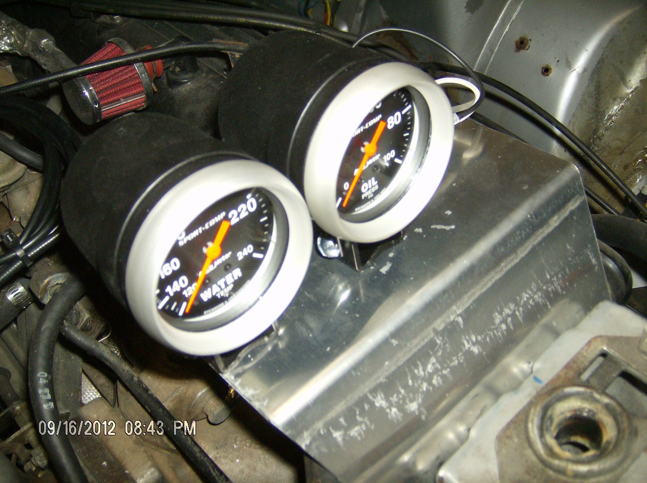

So earlier this year I put a cowl induction scoop on my damaged hood to forever rid myself of the vapor locking problems with the 240. I don't really like the hood as much as the stock look (which I love) but it did the trick.
So now I have my mechanical water temp and oil pressure installed, waiting on the third cup to add the fuel pressure. I plumbed the lights on the gauge faces to a 15 PSI pressure switch in the oil line, so if I loose pressure, I loose lights, just added peace of mind.

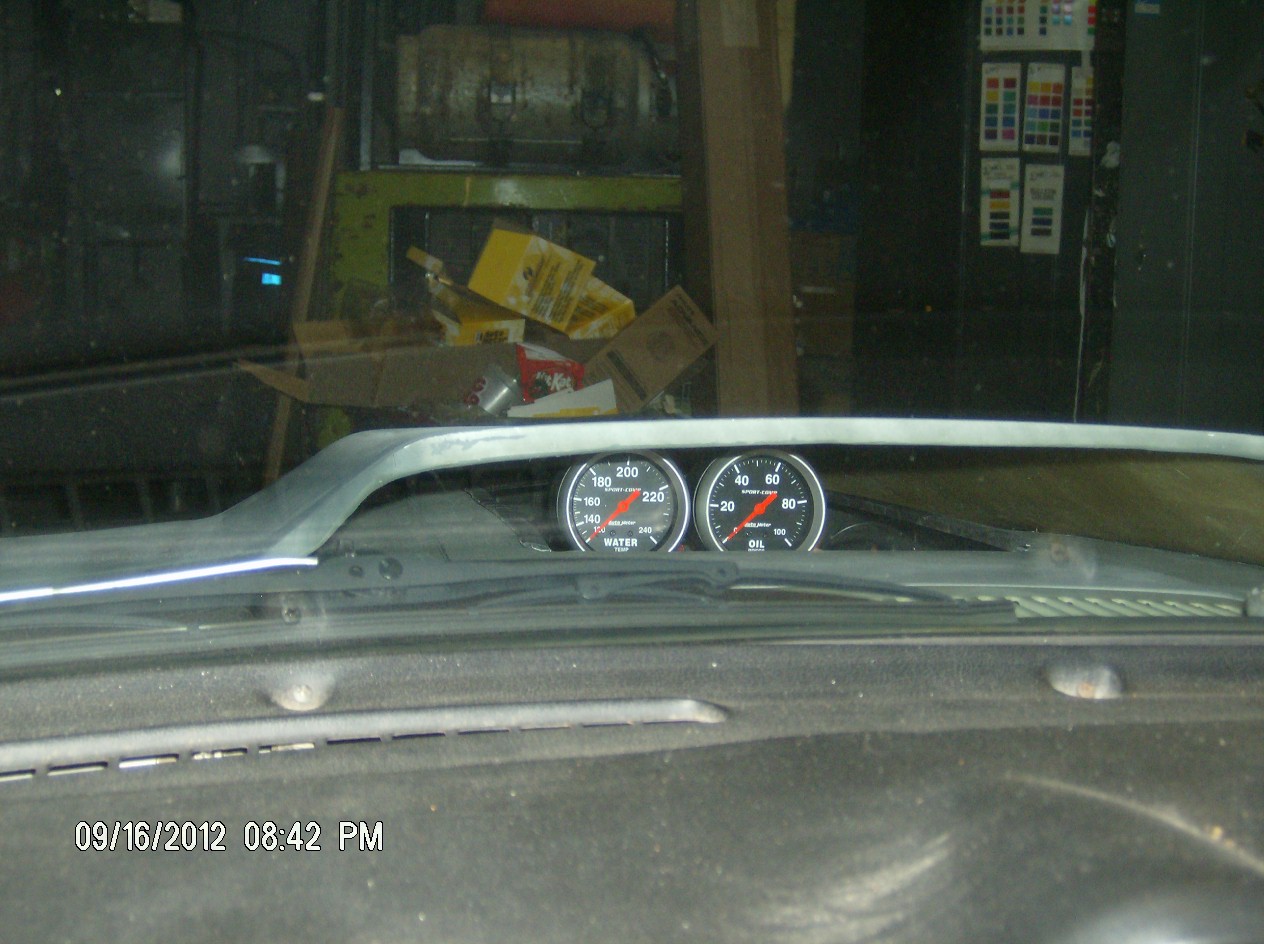

As seen from the drivers seat, the 2 5/8 inch autometers are easy to read and you don't have to take your eyes off the road. I like the hood a little better now.
