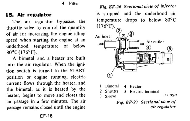

The AAR should have power supplied to the internal heater as long as the engine is running. It's on the same circuit as the fuel pump, I believe. So it should only cool down when the engine is not running. If your idle stays high at a light, it's most likely not the AAR causing it.
I disagree. The AAR will cool down and open almost immediately if you turn off the power, or faster if it has cooling air. The block with the coolant circuit inside is needed to keep the AAR closed while driving. Otherwise it will cool and open a little while driving.
I took your thread title literally, so described how it's supposed to work. The FSM description should help, attached. It shouldn't work like your describing yours as working.
It's conceivable that if the ambient air temp is low enough that the AAR wouldn't be able to maintain enough internal heat to keep itself closed. But I don't think that should be happening at 80+ air temp day.
If your AAR is opening and raising your idle while you are driving on an 80 degree day, then I think there's something wrong inside your AAR.
