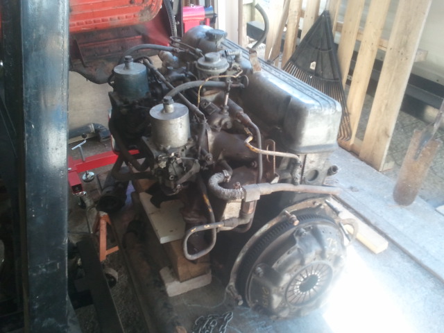

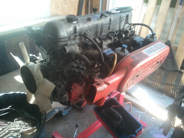

October 6, 201212 yr Author comment_403579 . YEAH. . 73 had allot of 'work' but i aint gonna tell ya it was professional thanks for the time spent with that reply here's what my ugly 73 looked like. and heres what my 71 motor that i never got to use looked like. Link to comment https://www.classiczcars.com/forums/topic/44572-new-sweety/?&page=2#findComment-403579 Share on other sites More sharing options...
October 7, 201212 yr comment_403599 Heh. I suspect there are very few 73's or 74's that still have all the emissions stuff still intact.Congrats again on the new purchase! If that body is as good as it looks, then you got a real nice one there! Link to comment https://www.classiczcars.com/forums/topic/44572-new-sweety/?&page=2#findComment-403599 Share on other sites More sharing options...
