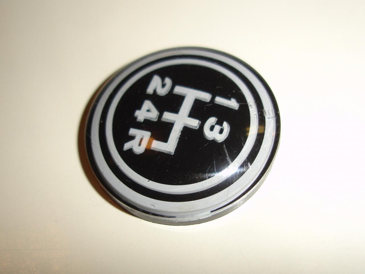

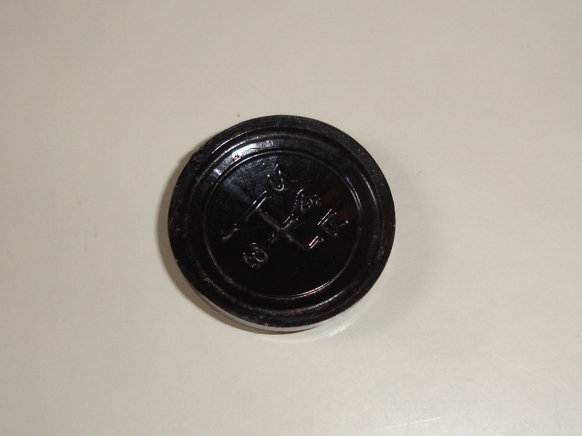

October 21, 201212 yr comment_404812 That "drop shadow" is going to be extremely difficult to reproduce in a 2d B/W print. Isn't the shadow a result of the MOLDED numbers and pattern? See the following pictures: Link to comment https://www.classiczcars.com/forums/topic/44587-5-speed-knob-reproduction/?&page=6#findComment-404812 Share on other sites More sharing options...
October 21, 201212 yr comment_404816 Yes, it will not be possible to get 2D drop-shadows to perfectly mimic a 3D feature. My existing art does a pretty good job of reproducing it around the letters, but suprisingly, the circles and shift pattern are actually more difficult. Link to comment https://www.classiczcars.com/forums/topic/44587-5-speed-knob-reproduction/?&page=6#findComment-404816 Share on other sites More sharing options...
October 21, 201212 yr comment_404823 there are slightly darker "shadows" that outline the numbers Mike, Thanks, I got it now. EScanlon is right in that it is caused by the fact that the numbers and shift pattern are molded and have height to them. Those shadows are actually white paint on the sloped sides of the raised numbers and lines. From looking at the pics that EScanlon posted, it appears to me that they molded (or maybe vacuum formed) the black part out of black plastic and then painted all the white features on by hand. Then they potted the top part in a clear material. I wasn't there when they made that thing, but here's what I see happening... First they mold the black plastic disk. Then they fill (inlay sorta) the outer two rings with white paint and wipe or buff off the excess resulting in a quality edge. Then they paint the raised letters. Then they mold the top dome in a clear acrylic or epoxy. All for about $1.29 Link to comment https://www.classiczcars.com/forums/topic/44587-5-speed-knob-reproduction/?&page=6#findComment-404823 Share on other sites More sharing options...
October 21, 201212 yr comment_404825 Actually, I believe the entire disk was molded in clear, with the letters and pattern in relief. The characters, rings and pattern are hand painted white and buffed off as noted, and then the entire underside is painted black. Simple and with a minimum of separate steps. Edited October 21, 201212 yr by Arne Link to comment https://www.classiczcars.com/forums/topic/44587-5-speed-knob-reproduction/?&page=6#findComment-404825 Share on other sites More sharing options...

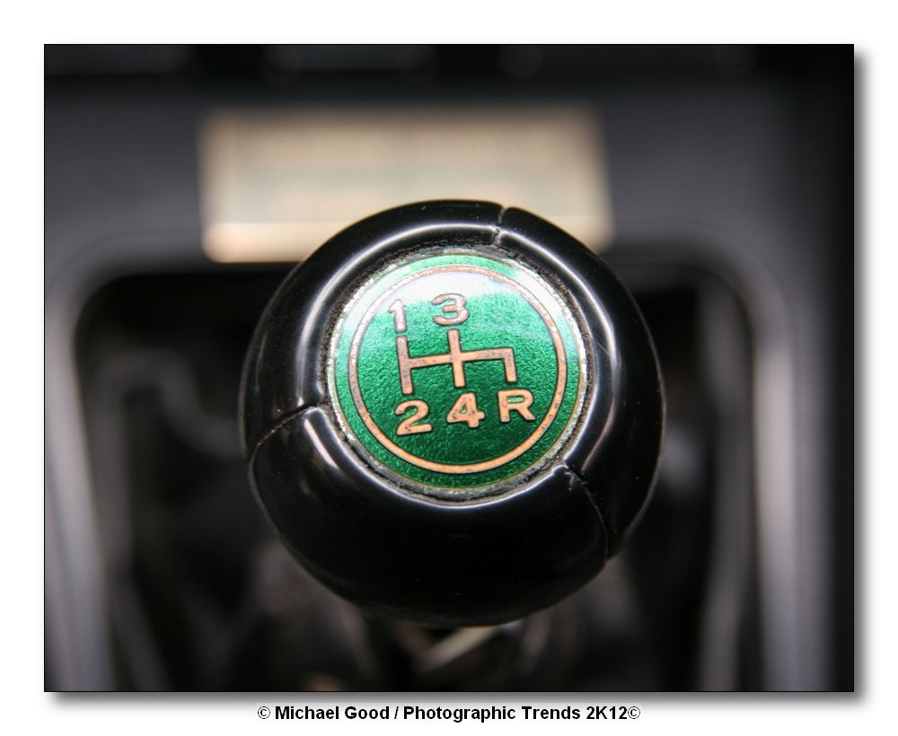

October 23, 201212 yr comment_405075 I am looking for the original green 76 - 280 4 speed pattern like the one pictured. I know it's different that the ones already shown, still looking though. Link to comment https://www.classiczcars.com/forums/topic/44587-5-speed-knob-reproduction/?&page=6#findComment-405075 Share on other sites More sharing options...

October 25, 201212 yr comment_405209 I am looking for the original green 76 - 280 4 speed pattern like the one pictured. I know it's different that the ones already shown, still looking though.[ATTACH=CONFIG]57375[/ATTACH]You may also try finding a black one and repainting it. Link to comment https://www.classiczcars.com/forums/topic/44587-5-speed-knob-reproduction/?&page=6#findComment-405209 Share on other sites More sharing options...
