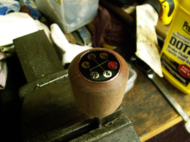

October 25, 201212 yr comment_405256 Koalia, Would you post a few more pictures of your 5 spd shift knob as in your post #30 but straight on to the knob instead of at a slight angle? The distance from the shift knob in post #30 I think is good to make an artwork that might have shadows though a straight on picture should make the "shadows" show up balanced. Thanks,Mike Link to comment https://www.classiczcars.com/forums/topic/44587-5-speed-knob-reproduction/?&page=7#findComment-405256 Share on other sites More sharing options...

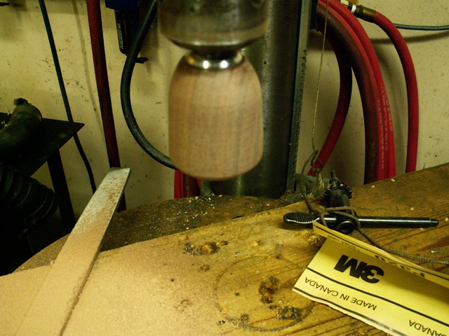

October 31, 201212 yr comment_405762 I purchased one of those fat shiny knobs but it just doesn't feel good in my hand and when I saw this thread I got an idea. Found an old metric bolt that fit it, cut off the head mounted it in the drill press. Using a coarse file and 4 different grades of sand paper brought it down to this, not really original looking but much more comfortable and I can see and feel the wood grain now. Link to comment https://www.classiczcars.com/forums/topic/44587-5-speed-knob-reproduction/?&page=7#findComment-405762 Share on other sites More sharing options...
October 31, 201212 yr comment_405771 Nice job..... and with primitive tools!Dennis Link to comment https://www.classiczcars.com/forums/topic/44587-5-speed-knob-reproduction/?&page=7#findComment-405771 Share on other sites More sharing options...

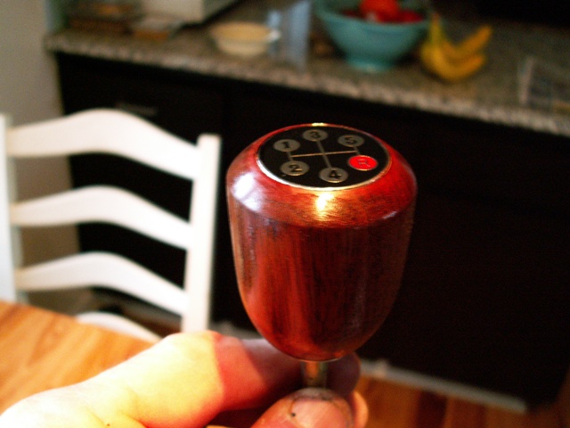

December 1, 201212 yr comment_408129 and one original knob resto-modded with the metal emblem from a later knob. That's pretty much what I ended up with. One thing to watch for is that the metal cloisonné style maps are a little smaller in diameter than the plastic ones. That's the reason for the flat ring at the top of my knob. I modeled my wood just like the original wood knobs, but with the shift map smaller, you end up with a narrow flat. If the map were slightly larger in diameter, then the flat width would be reduced: It doesn't bother me and I didn't even realize it until I went back through this thread and looked at the other five speed knobs. The point is, that if you're trying to put the cloisonné map into an older knob, you'll have to deal with the moat around the edge where the new map rattles around in the larger opening. Link to comment https://www.classiczcars.com/forums/topic/44587-5-speed-knob-reproduction/?&page=7#findComment-408129 Share on other sites More sharing options...
