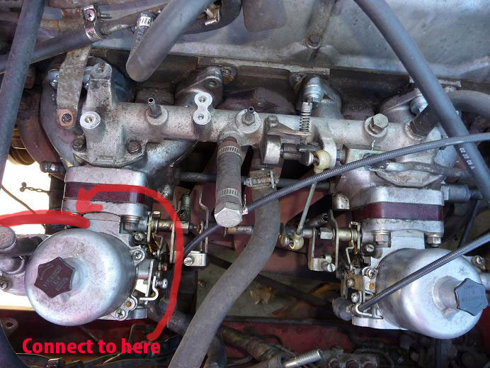

OK, now back to my usual dumb questions. Where exactly did the vacuum control hose originally run - from the distributor to... where? My thought is that it probably attached to the stock intake manifold someplace, but I've got a triple Weber setup on the car so I need an alternative spot to make the connection (short of running the hose all the way to the rear section of the intake manifold, which is where the previous owner had put it). Any ideas?
Triple Webers don't have a ported vacuum source, that's a hose to nowhere.
You could try using the vac advance referenced to manifold vacuum but don't expect the results to be great. You'll likely end up with static timing too retarded, thus limiting WOT performance. FWIW, tailoring a spark-advance curve to an engine is not trivial.

triple Webers run better when you do not use the vaccum advance. This is probably why yours was not connected.
Don't quote that site, there are tons of misconceptions in there, especially the Weber section.
