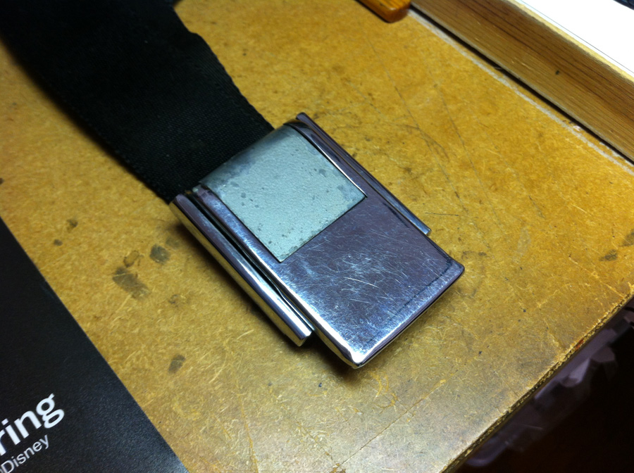

December 22, 201212 yr comment_409867 Ok, found some original style belts on ebay... got them the other day. chrome and belts are OK, but part of the female end seems to have been painted and its chipped ( see image ) - should it be painted, if so, does anybody know the color? its a greenish grey.... Link to comment https://www.classiczcars.com/forums/topic/44639-240z-seat-belt-hangers/#findComment-409867 Share on other sites More sharing options...
