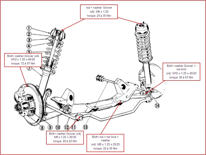

Posted October 13, 201212 yr comment_404107 Hey all. This is gonna get me back to working on the z after a long hiatus. I have the whole front suspension off. Painstakingly wire brushed and por15. Got an ES poly master bushing kit and adjustable illumina struts. Was a lot of hard work but fun. Now getting ready to reassemble. I had all my fasteners nicely labeled in bags.Around the time I started I was given a pup. I guess he saw how much fun I was having that he wanted to help. Got home to find him inside the fastener box with the lawn covered with torn bags and scattered fasteners. That stopped everything, I thought it was the end.I recovered what I could. I was surprised to see zinc on most of them even after all this time. Researched and found info on all the fasteners for the front. I'm planning on replacing the missing ones. Down the line, new ones all around would be nice.So what's my best bet on getting them? Can't find kits for the suspension. I know I can get them from a hardware store, bolt companies, or maybe Nissan. I just don't want someone to give me a weaker grade or some IKEA bolts or something. A safe z is a good z. Link to comment https://www.classiczcars.com/forums/topic/44661-fastener-woes/ Share on other sites More sharing options...

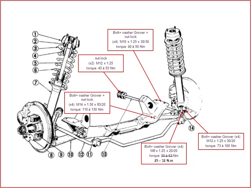

October 17, 201212 yr comment_404457 I believe the pictures below are what you're looking for Use only grade 10.9 bolts & grade 10 nuts. Those are not easy to get since they all have small pitch but this is what you need. Grower washers are the spring loaded washer type for your information. Link to comment https://www.classiczcars.com/forums/topic/44661-fastener-woes/#findComment-404457 Share on other sites More sharing options...
