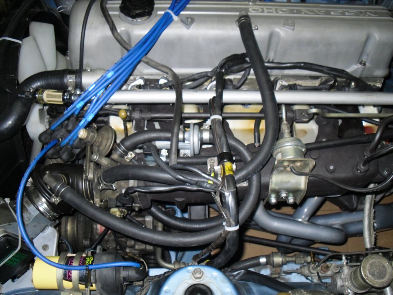

Guys, after you are done coating the tank, don't forget to put a clear filter between the tank and the fuel lines to help catch crap that was left behind during the cleaning and coating (yes, there will be some...). Change the filter after the first tank. I found this to be a great way to protect all of the new fuel system components I installed downstream from the tank on my Z.

Can someone send me a picture of where they added the clear fliter.

That sounds great! I ran down stairs to take a picture of the Fram G3 filter location and quickly realized the cars not here :stupid:. The line coming straight from the tank is like a 3/8's hose and the one going into the pump is smaller so be ready for that, maybe have some different size clamps. Put it between the tank and the fuel pump. I use needle nose vise grips to clamp off the line straight out of the tank so you won't get doused with fuel, but wrap a rag or use two small popcicle like pieces of wood so you won't tear into the hose with the vise grips. You can buy those filters at Walmart for $3 or $4 bucks. I don't have a pic of the tank filter but here is my glass filter right before the fuel rail. Never has it been dirty or pink looking. That G3 plus the OE filter, which is huge, are enough I just overkill everything. Glad you got that done without any problems. Saved $$$$.

I'm pretty sure I used the same hose that was there. I remember one of the hoses was larger in diameter and wasn't sure if it would seal off, but it did. I wish I could put up a picture for you but my car's not available for glamour shots right now, sorry. I just googled images for it. Check these out.
