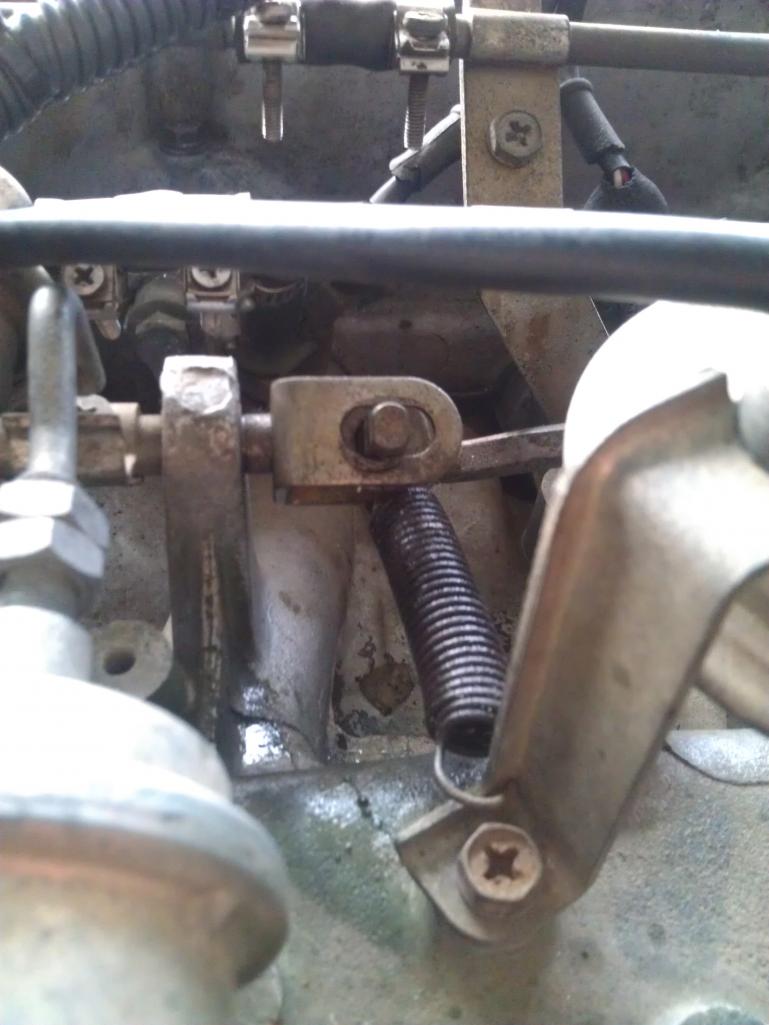

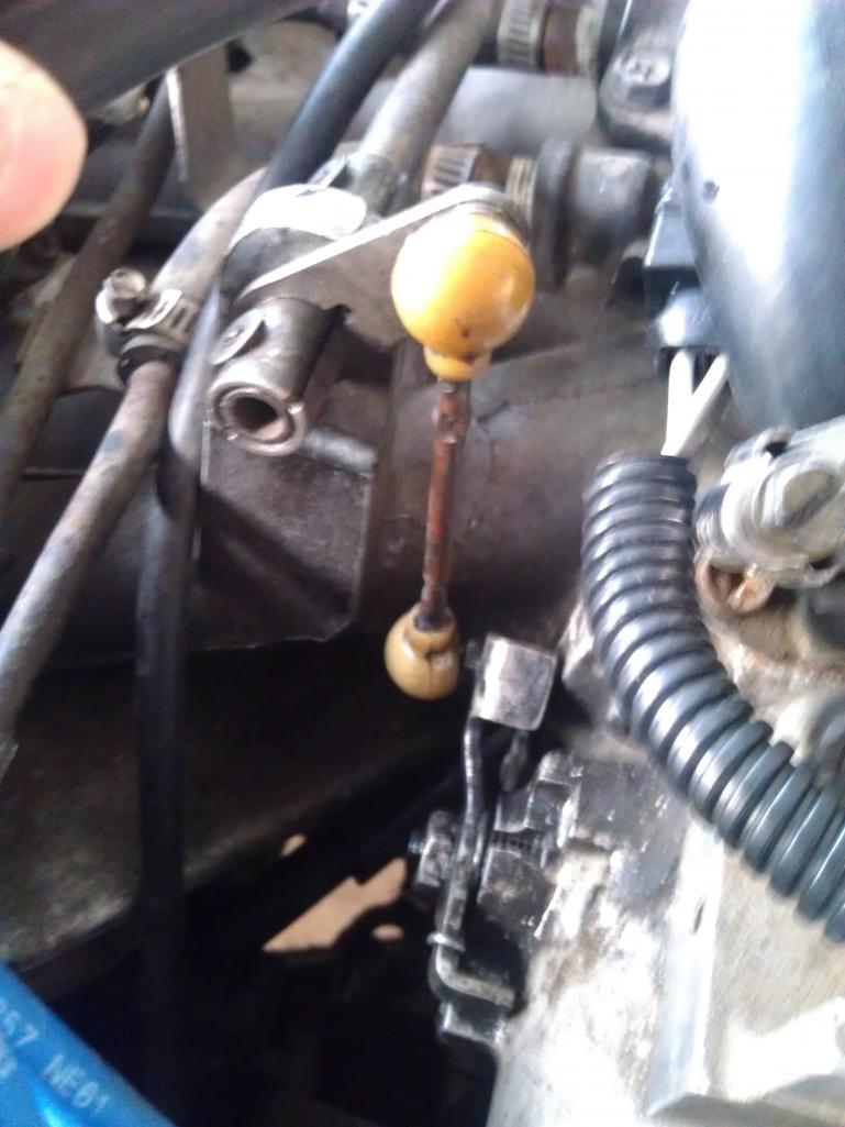

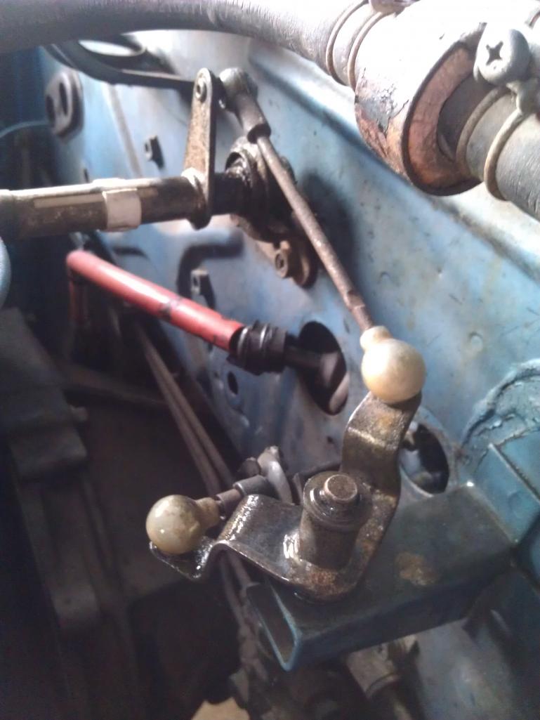

Okay guys, was able to mess with the z for about a half an hour today and i think i found the problem to the fast idle it was having. The throttle is sticking! Just to note this is not the stock throttle body, the PO had installed the 60mm throttle body, there is a spacer that's suppose to go in between the throttle body and intake manifold but i had that removed because that was blocking off the AAR hose that goes into the throttle body so i don't see how that was suppose to work? Unless it was designed like that? .. I noticed when i would hit the throttle the Pivot ball looking thing on the throttle linkage it would not go back "all the way up" There is some play from the throttle body and the throttle linkage. If i would hit the throttle it would go normal but after i let go it would stick and stay at around 1400 RPM, If i fiddled with the Pivot ball thing moving it up very slightly and the idle would drop back down to 900-1000. The idle adjustment screw seems to have fixed it self or something because it seems like it still has some turns that'd drop the idle slightly, but if i started turning it in more i would hear weird noises, i may need a valve adjustment? Also filled in that small leak between throttle body and intake manifold with some RTV ain't the best looking but it seemed like it worked. I have some pictures attached of the linkage... How would i go about fixing this? Or is there adjustments to be made..
