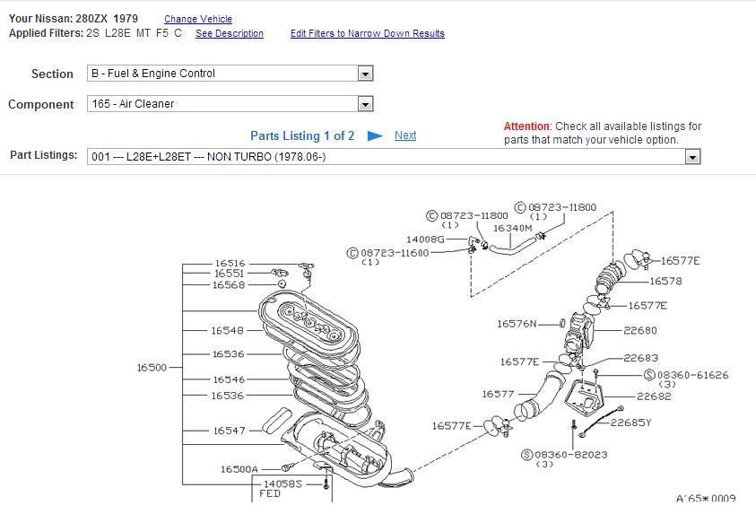

New guy here so please be kind. Just got a 79 280zx for FREE. I noticed it has a crack all the way through the rubber boot between the mass air flow to the throttle body. No new part available, can't find one used. I don't have much money right now but would like to buy a used rather than repairing mine. Any idea's?????:cool: Thanks Mike
The 79 and 80 share the same hose nissan P/N# 16578-p7100

My local Nissan dealer says it is obsolete and no dealers across north america has this hose in stock.:disappoin
You could try the hose for the 280zx 1980 model. You will need to block the extra side hose nozzle. MSA sell them, I think.

I had the same problem, a torn boot. Like you, I could not find a replacement, so I "engineered" it.
I cleaned the area of the tear with acetone. I super glued as much of the tear as possible (maintaining the original shape). Then I coated the area (inside and out) with liquid rubber.
Ta-Da...it worked!!!
