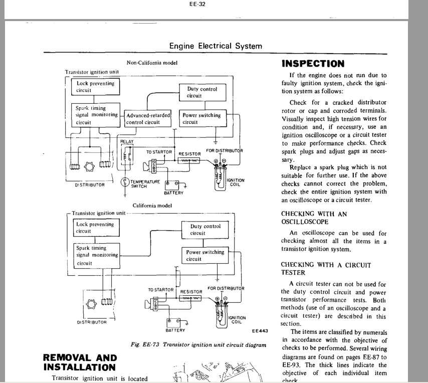

I'm thinking the Fuel injection relay may be bad, but it is just this thing under the dash to the left of the driver's knee. How can I test the thing before laying out $80 or so to get a new one that I might not need. Some issue goes for the Ignition Control Module. I'm not sure how to test one of these before spitting out a couple hundred.

So I'm back to square one. I'm going to rethink this. I need to check again to see if starting fluid sprayed into the manifold will do anything. I need to double-check the spark to prove whether or not I really AM getting spark. Questions.... could the ballast resistor for the coil be bad? Could the distributor need replacement?
