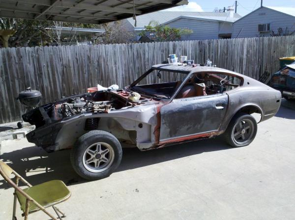

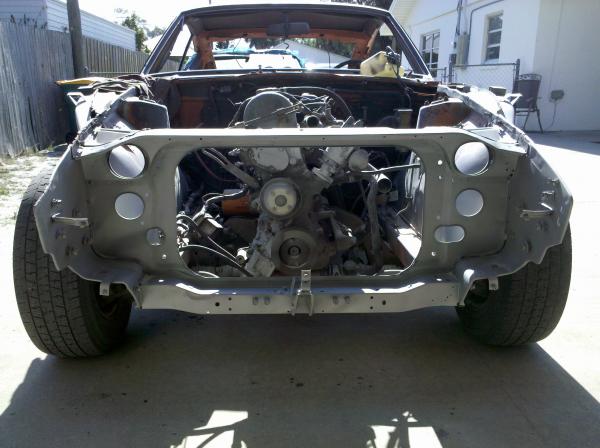

Ok. I'm on my little nexus tablet and it's 4:30am, so this isn't going to be the most elaborate of posts.
Your guys assumptions of undercoat are correct. I have no clue when it was done, or if it was done professionally. I am eager to find out when we get to the blasting stage. I want to see if it is hiding anything. The floor pans are rock solid though so I hope everything is good there.
The passenger side door I had a feeling it was from a laterr/different model due to the latch and interior paneling. Here are two pics from last year when I went over the car. Annndd... They won't paste from here for some reason. Will post them later.

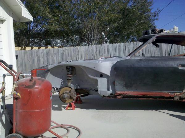

I made some little headway today. I wanted to get it in the garage again, it had to live outside the past week or so while they poured the floor. Even with a jump, it wasn't firing. I hesitantly put a few fresh gallons in the tank (I planned to drop the tank soon so didn't want to have to deal with draining gas). Pumped the gas and bunch and made sure fuel was getting there. Next I checked the plugs. They were completely gunked up and looked to have never been changed. I ran to the auto store and picked up new plugs. Put those in no problem. BTW, first time changing a spark plug LOL.
Next I followed the wires back to what I now learned is called a distributor. Opened that up. I cleaned the contacts really well. Inside there was also a really loose wire that was barely attached and constantly hitting the spinning part. I made sure the wire was still intact, tightened the wire down and readjusted it so that the wire was no longer in the way. Sorry for the lack of proper terminology. I didn't even know how an old spark plug system worked until today.
Once I did all of this, I fired it up. First go it started right up and stayed running. Fast forward 5 minutes and it is overheating. I ran through all the hoses quickly and found 2 significant leaks. They were easy enough to get to and my parents should had the hose we needed. I replaced that and used new hose clamps.
Anyway, I did that and built those two parts carts in the few hours I was out there today. Doesn't seem like much but in the first two hours I've already learned a good deal. Also, if you buy things from Harbor Freight, expect to have to re drill just about every damn hole...!
At the end of the day I drove it around the block once and put it in its garage spot. I realized the transmission may need to be rebuilt /replaced. I don't know what a normal amount of slop is in a 240, but I had to pretty much guess what gear I was putting it into. Also, the ebrake does not function... =)
