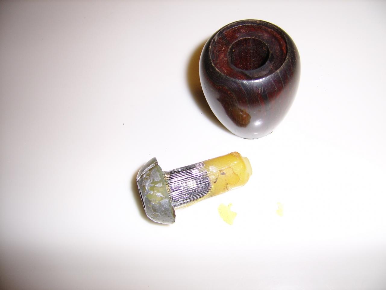

November 15, 201212 yr comment_406887 Captain Obvious said: Thanks for the pics geezer. Your stock knob is certainly much darker than the other OEM knob pictures I've seen. Are you sure it wasn't stained darker than original? Maybe it was completely dunked and is stained on the inside as well making it look like it's the natural wood color? It appears to be the original natural wood color but being the 4th owner, anything could be possible and I noticed someone did paint the base with aluminum color paint. I did spin it and removed the scratches starting with 220 grit and progressed to 800 and then a gloss polish. The wood is the same color throughout. Even the hole where the glue remnants were cut away it revealed the same color wood. My best guess, thats the way it was originally. I've seen a few variances in the coloring of these knobs. I believe it is just the nature of wood. Edited November 15, 201212 yr by geezer Link to comment https://www.classiczcars.com/forums/topic/44856-making-a-wooden-shift-knob/?&page=4#findComment-406887 Share on other sites More sharing options...
November 15, 201212 yr Author comment_406908 geezer, Thanks again for the info. I don't know how deep stain penetrates, but it sure does look like the wood color, doesn't it? Is your plastic insert split? It looks like a crack along the back top in your pic? I'm thinking for my next knob attempt I'm going to make an insert like that, but I'm going to make mine out of metal. Either aluminum (easier to work with), or stainless (will look more like the original and will stay shiny longer). hls30.com, Thanks for your info too. I've got a line on a solo retired pin that is just itchin' to be turned into a shift knob... Link to comment https://www.classiczcars.com/forums/topic/44856-making-a-wooden-shift-knob/?&page=4#findComment-406908 Share on other sites More sharing options...

November 15, 201212 yr comment_406935 Captain Obvious said: ...Is your plastic insert split? It looks like a crack along the back top in your pic? I'm thinking for my next knob attempt I'm going to make an insert like that, but I'm going to make mine out of metal. Either aluminum (easier to work with), or stainless (will look more like the original and will stay shiny longer).Yes, my insert is split. I think more are, than are not. If you get a limited run of inserts made from a suitable metal and consider selling them, put me on the list for one. I'll even send you my split original to use for a dimensional example if you like.I've even been considering having a shift map button done in aluminum by a local machinist and painting it up. It wouldn't fool anyone but might look nice just the same. Link to comment https://www.classiczcars.com/forums/topic/44856-making-a-wooden-shift-knob/?&page=4#findComment-406935 Share on other sites More sharing options...
