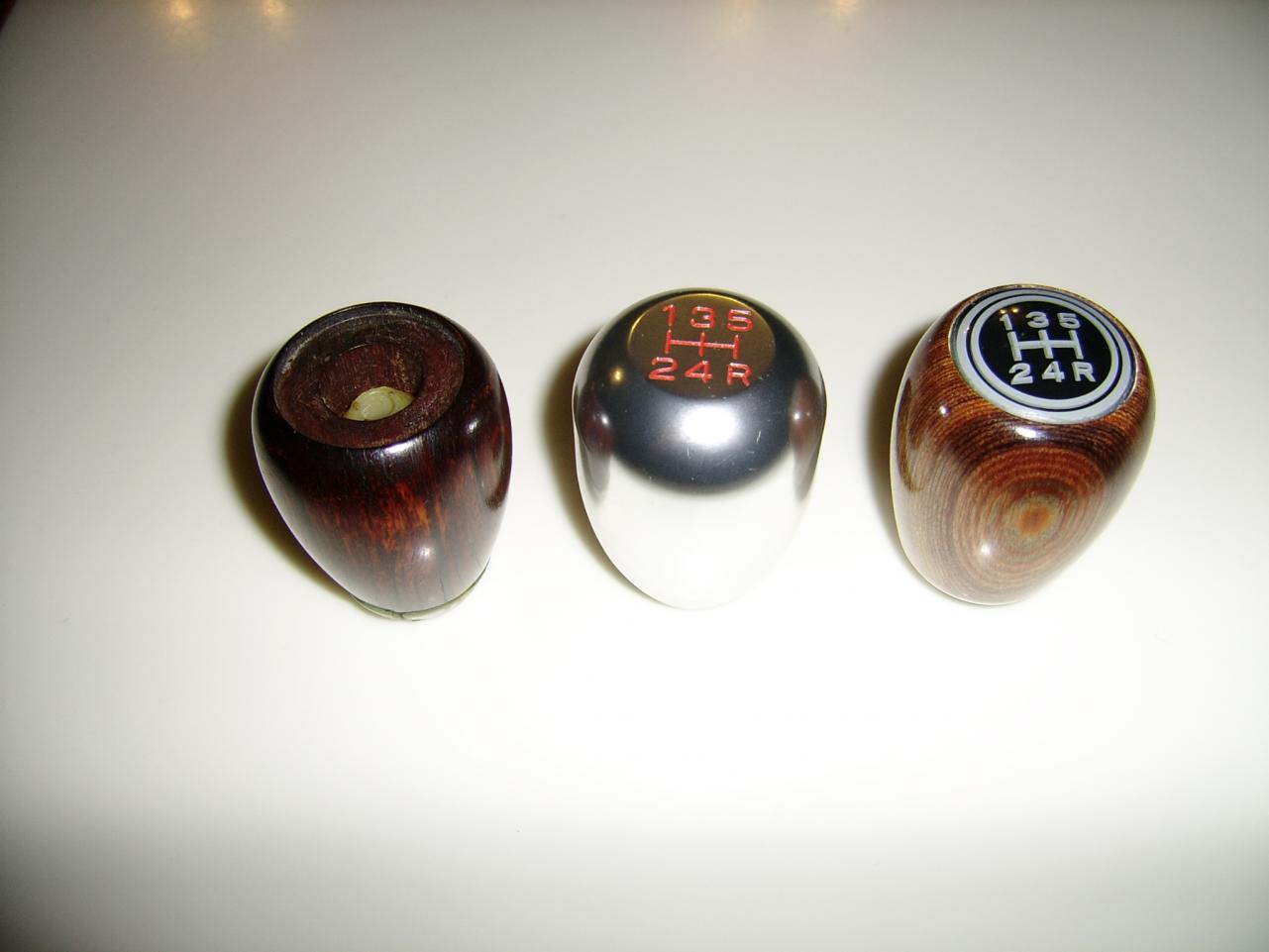

December 1, 201212 yr comment_408142 Thats cool Capt! Nice coloring, looks great! I have the $9.00 aluminum knob that I bought on Ebay in order to dissect. The font is slightly larger and the inner circle will have to be cut right into the ridge around the map to lessen its presence. Really can't round that ridge off much without cutting into the shift map. Once both circles are cut and I have it powder coated black with the white lettering, I'll post a pic of it mounted in my original knob. I've been studying it to see if the bottom insert can be cut from this knob as well. It can, but I would have to enlarge the inside hole in my original knob to recieve it. I wanted to avoid that so, I may just make a new insert that can fit the existing hole. Edit: Woops, this should have been posted in the Making a Wooden Shift Knob thread. Can anyone move it? Thanks. Edited December 1, 201212 yr by geezer Link to comment https://www.classiczcars.com/forums/topic/44856-making-a-wooden-shift-knob/?&page=7#findComment-408142 Share on other sites More sharing options...

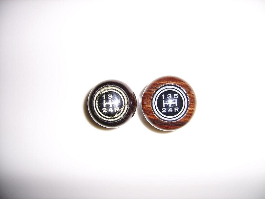

December 2, 201212 yr comment_408216 Geezer, Is the 5 SPD shift knob in your picture the same as the one provided with cars that were sold in Europe with a 5 SPD? If it is would you take a picture of it straight on looking at the map, not at an angle and post it here? If you can get more close up that would be great too! Thanks,Mike Link to comment https://www.classiczcars.com/forums/topic/44856-making-a-wooden-shift-knob/?&page=7#findComment-408216 Share on other sites More sharing options...

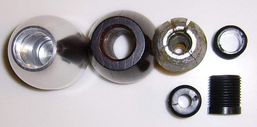

December 2, 201212 yr comment_408217 Capt, thanks for the interest in this concept. No material needs to be removed from the top. Both circles can be cut starting at the edge of the flat and emulate the original in size, as well as fit perfectly into the recess in the top of the knob. Once powder coated and the white circles and map are applied, I'm hoping it looks quite similar, just made from different material and be more durable as well. This pic may help you visualize the delemma with making an insert from the remains of the knob. The inner thread is much larger because of the plastic adapters used to make the knobs a universal fit. Only so much material could be removed before reaching a safe diameter that won't weaken the thread. It can be done but the hole in the stock knob would need to be a greater diameter, thus perhaps weakening the old wood. It is plain to see how the original knobs were made from two booked pieces joined together as I mentioned before. Link to comment https://www.classiczcars.com/forums/topic/44856-making-a-wooden-shift-knob/?&page=7#findComment-408217 Share on other sites More sharing options...

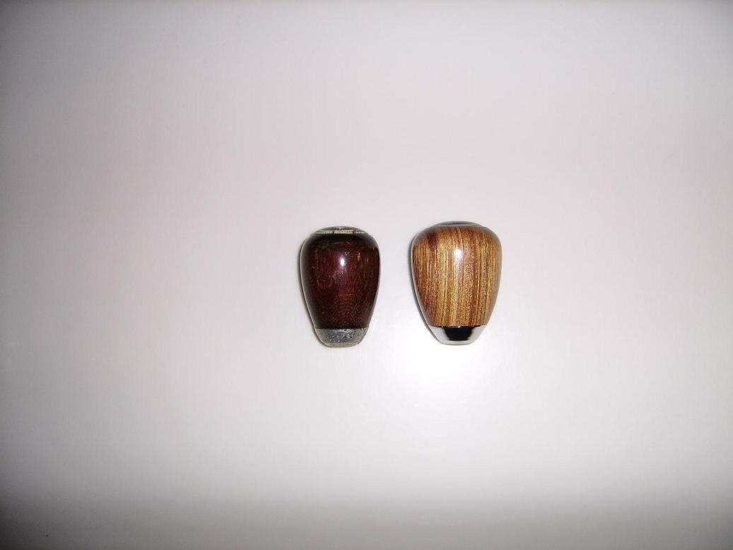

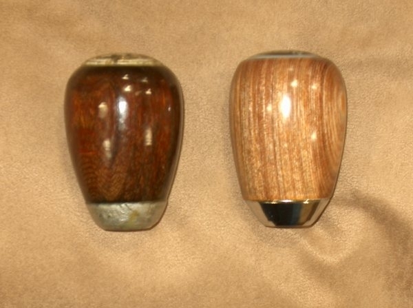

December 2, 201212 yr comment_408222 Mike, That is a new OEM 5 speed knob that I turned down a few years ago. It was much larger in diameter originally. In the 3rd pic after turning it down, you can see it is shaped differently than an original stock knob and is a bit taller as well but still quite an improvement over a new OEM IMHO. The first pic as well as the overhead pic showing the map is before I turned it down. The milky white coloring of the map still throws me off too. Why they changed that as well as the dimensions is a mystery to me. Edited December 2, 201212 yr by geezer Link to comment https://www.classiczcars.com/forums/topic/44856-making-a-wooden-shift-knob/?&page=7#findComment-408222 Share on other sites More sharing options...
December 2, 201212 yr Author comment_408240 geezer, I see what you mean about the thread mount. I wasn't aware that the aluminum knob had plastic inserts to adapt to different cars. Here's an idea... Can you move the base portion from your new OEM replacement knob over to your original knob? Does the new OEM have the same center hole as the old OEM?Sounds like a lot of people have plastic bases that have seen better days... Haha! Maybe I should get into the threaded base business? That and AAR's :pirate: Link to comment https://www.classiczcars.com/forums/topic/44856-making-a-wooden-shift-knob/?&page=7#findComment-408240 Share on other sites More sharing options...

December 3, 201212 yr comment_408304 Geezer, Thanks for the straight on picture.Mike Link to comment https://www.classiczcars.com/forums/topic/44856-making-a-wooden-shift-knob/?&page=7#findComment-408304 Share on other sites More sharing options...
