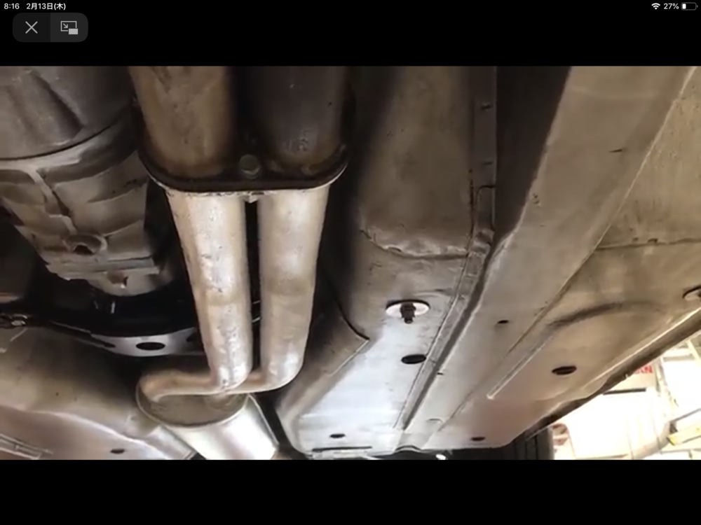

February 13, 20205 yr comment_592539 The foot rests were standard items on JDM cars. My 1972, FZ-L has it. Note that the floor has reinforcing where it bolts through. Link to comment https://www.classiczcars.com/forums/topic/44860-my-two-swiss-s30z-fairlady-restoration-build-thread/?&page=46#findComment-592539 Share on other sites More sharing options...
February 13, 20205 yr comment_592540 Passenger footrest was standard equipment on 'DELUXE' models in Japan, and an extra-cost showroom order option on 'STANDARD' models. Link to comment https://www.classiczcars.com/forums/topic/44860-my-two-swiss-s30z-fairlady-restoration-build-thread/?&page=46#findComment-592540 Share on other sites More sharing options...

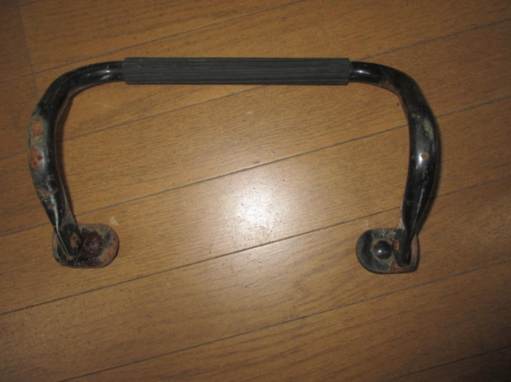

February 13, 20205 yr comment_592542 On 2/3/2020 at 6:13 PM, JDMjunkies.ch said: Two weeks ago i found a footrest for the 240Z for sale on a local ads-website. I remember i've seen them before but never really investigated about them. Both my cars came without them. This particular item was from a 260Z 2+2 and got a fair price-tag, so naturally it gathered my interrest. Turns out that the parts fiches say that it's the same unit as used in the 240Z (both LHD and RHD) and was an optional item. I love optional stuff. and since it was cheap and seemed to be in easy restoreable shape, i had to get it ? And yesterday i finally got the package with it. It's a bit rough around the edges but when in bring my next bunch uf parts for sandblasting and powerdercoating this will go in the same delivery: I'm not really sure how "rare" this item is, but i think i've never seen it on a swiss car. And as a serious parts-hoarder i love to collect these things anyway ? I think they are rare outside Japan. I have had a few come through my hands, and there is slight differences between them, about 5 or 6. As you see yours has both "feet" facing the same way, and the bottom of the feet are square. https://page.auctions.yahoo.co.jp/jp/auction/g375566873 As you see, the "feet" face each other, and bottom of the feet are rounded. There is also differences in the bolts to fix the footrest to the car, some are round headed like yours, some are slotted head. And the rivet holding the hoop and the feet differs too. If you blast it, cover the ribbed rubber bit, as these aren't avaliable, I had to reproduce it for my footrests. Edited February 13, 20205 yr by RIP260Z Add bit Link to comment https://www.classiczcars.com/forums/topic/44860-my-two-swiss-s30z-fairlady-restoration-build-thread/?&page=46#findComment-592542 Share on other sites More sharing options...

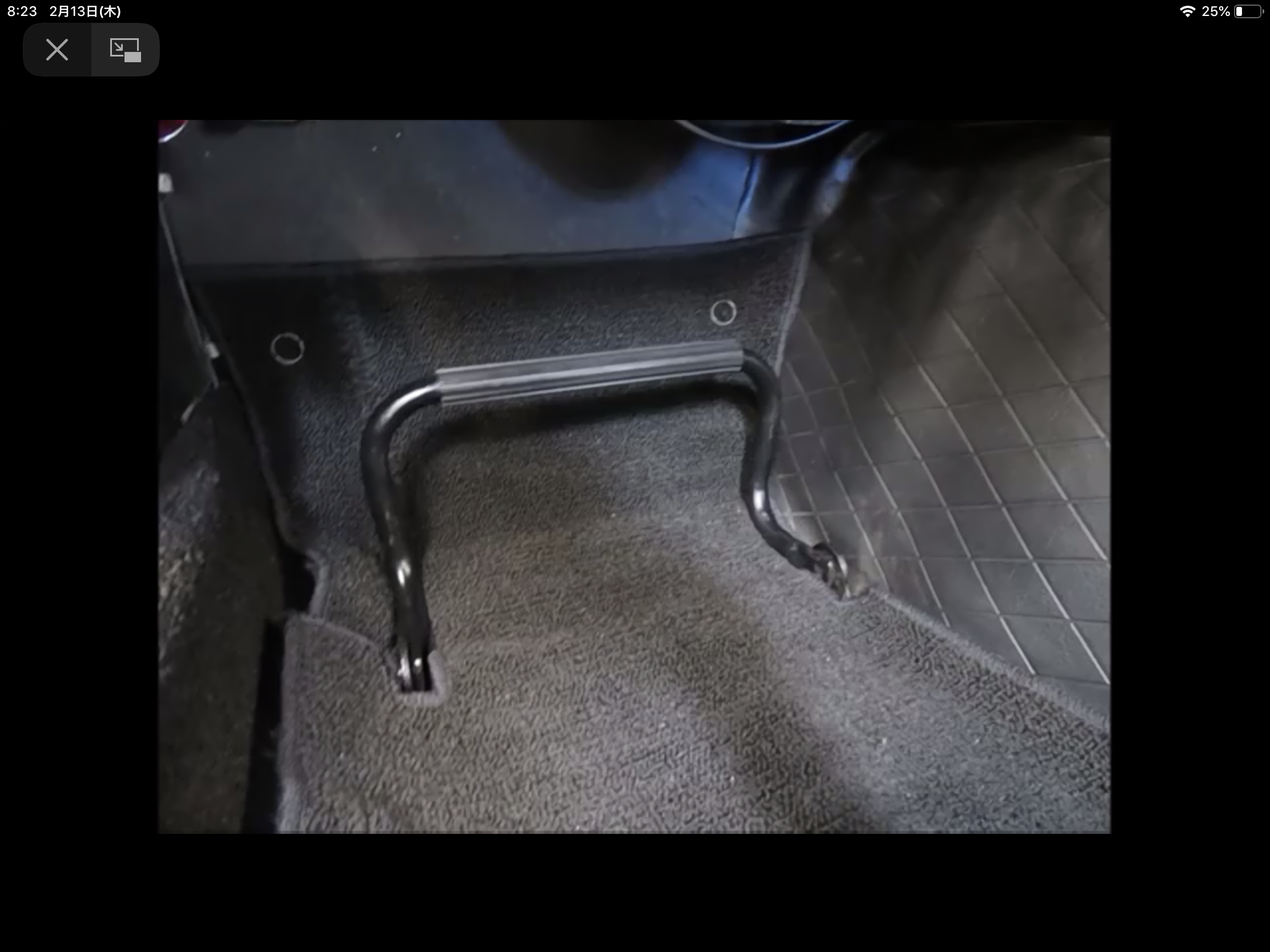

February 14, 20205 yr comment_592580 On 2/13/2020 at 1:29 PM, RIP260Z said: I think they are rare outside Japan. I have had a few come through my hands, and there is slight differences between them, about 5 or 6. As you see yours has both "feet" facing the same way, and the bottom of the feet are square. https://page.auctions.yahoo.co.jp/jp/auction/g375566873 As you see, the "feet" face each other, and bottom of the feet are rounded. There is also differences in the bolts to fix the footrest to the car, some are round headed like yours, some are slotted head. And the rivet holding the hoop and the feet differs too. If you blast it, cover the ribbed rubber bit, as these aren't avaliable, I had to reproduce it for my footrests. Hi Ian , you are very accurate about the detail of the foot rest , yes the one in Yahoo auction is the correct for the Fairlady Z from the beginning (Oct 1969 ) to 1973 or later . scotta , also a good observation about the reinforcement for the foot rest , early Fairlady Z series ( unknown time period) doesn’t have the patch on the floor. Please see my silver 01/1970 Z432 , there is no reinforcement on the floor (I put a big washer to prevent the floor from being bent , that is not original) . My 06/1972 Fairlady 240ZG has reinforcement patches . Kats Edited February 14, 20205 yr by kats Link to comment https://www.classiczcars.com/forums/topic/44860-my-two-swiss-s30z-fairlady-restoration-build-thread/?&page=46#findComment-592580 Share on other sites More sharing options...

February 14, 20205 yr comment_592587 On 2/14/2020 at 3:27 AM, 7tooZ said: @KatZ I am curious about your floor mat. Is it a Custom Version? I have an aftermarket version that is very similar to the photos here except is chrome not black It is new and still in the original box. Hi , the floor mat is made by Mr.Sudo with very close to the original material , loop pile carpet . I am so happy with it . What part of the carpet “ chrome or black “ are you referring to ? Kats Link to comment https://www.classiczcars.com/forums/topic/44860-my-two-swiss-s30z-fairlady-restoration-build-thread/?&page=46#findComment-592587 Share on other sites More sharing options...

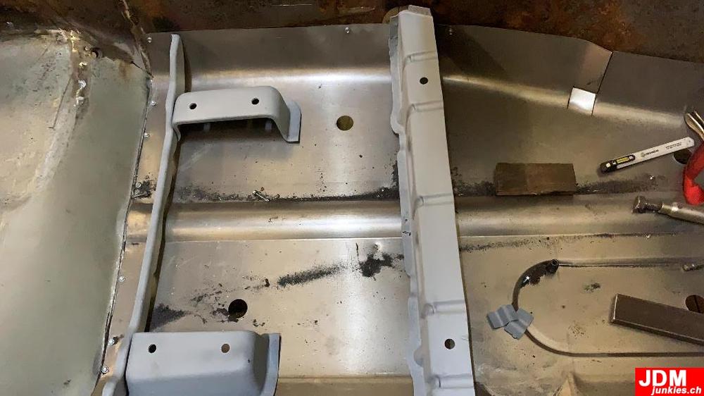

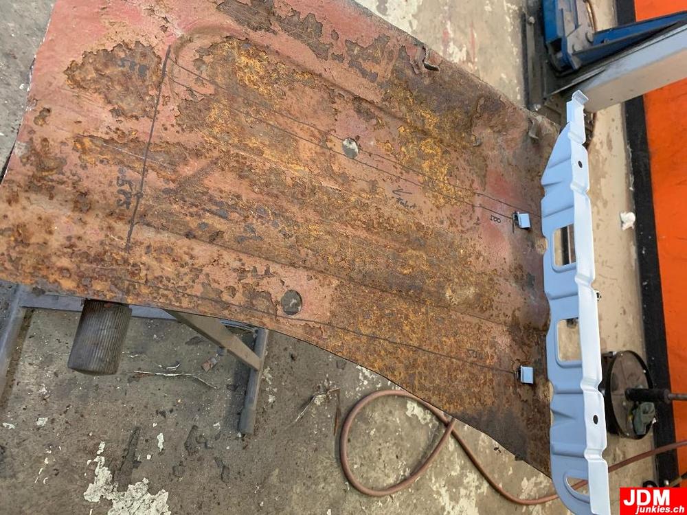

March 10, 20205 yr Author comment_594050 Well the last week have been pretty busy at work, and i'm still working on some details of the house. but everything is finally calming down now and i have plans to kickstart the Z-project again soon and get some long overdue work done over the next months. So i got in touch with my Bodyshop guy to discuss a few details and then i just got an update from him from today. The old seat brackets got removed and sandblasted: Primered: And test fitted on the old cutout floorpan: And theis is how they look on the new floorpan, ready to weld it all back together: Link to comment https://www.classiczcars.com/forums/topic/44860-my-two-swiss-s30z-fairlady-restoration-build-thread/?&page=46#findComment-594050 Share on other sites More sharing options...
